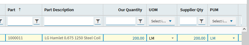

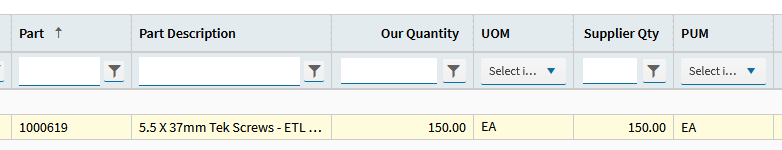

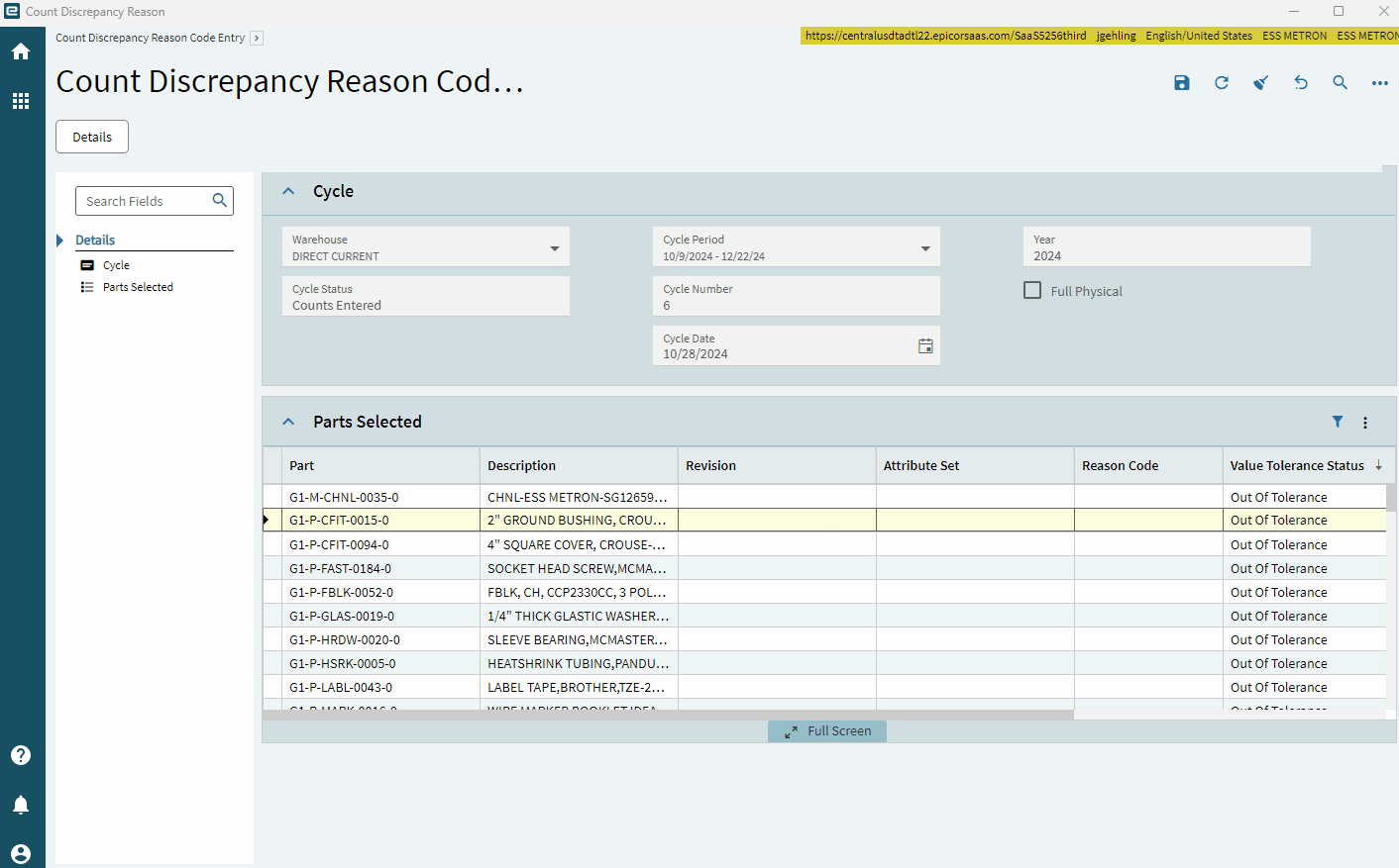

Can confirm issues with the grids after the 2024.2.4 update. Seems they are totally broken across multiple apps. For us we are seeing it in PO approvals, material queue manager, and cycle count discrepancy reason codes apps. Here is are examples from cycle count and mtl queue manager
1
2
