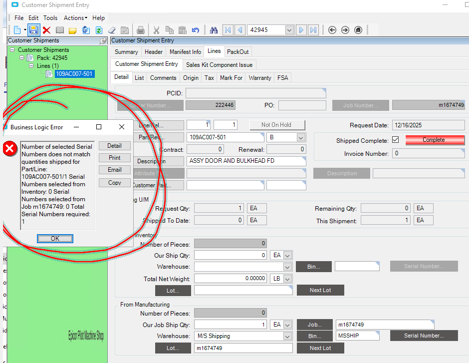

When I create the packslip and press save, I get this error circled below.
Then I go in and try to add the serial number (the one that is linked to M1674749 job) but there is no serial number to select. So I’m stuck. Thoughts?

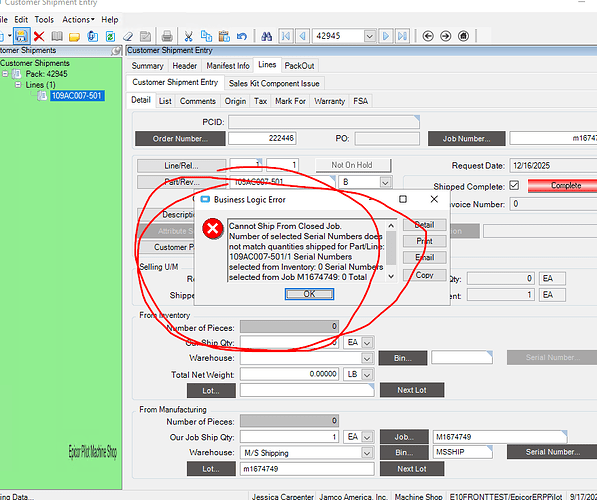

This is the error I get if the job the serialized part to is closed -
