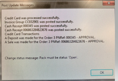

You get the window that shows the following Post Update Message

When shipping a credit card order, the invoice is created, funds collected from your merchant account, cash posted, and invoice closed.
You can print the invoice from Mass Print Invoices or Invoice Tracker.

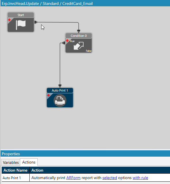

Has anyone had any luck with setting up AR invoice printing for Credit Card orders? I have created an Data Directive (Standard on InvcHead) that is emailing the customers their invoice for Credit Card orders at the time of shipment. The BPM works fine and executes when testing until I replace a test email with my APR Invoice Form. The invoice form is giving me the error that “No invoices selected to print” (full error below). However, when I manually go to A/R Invoice Tracker and run the routing rule for that report style, it runs and emails me without a problem. I have disabled the SSRSRouting on the Autoprint BPM and it continues to give the “No invoices selected to print” error. So I know the error is not related to my routing rules on the SSRS Breaking and Routing.

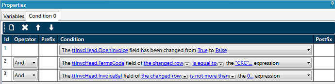

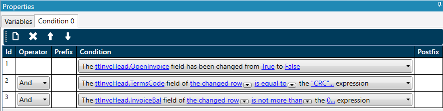

what does your condition look like?
That looks good, here’s how mine is configured so you can compare.
I setup an in-transaction data directive on InvcHead with a condition which looks similar to yours.
Instead of the terms code, I use the Invoice GroupID setup under company config for Credit Card invoices because the terms code is not tied to credit card processing out of the box in epicor.
If the condition is met it enables a standard directive which has the auto print action. Make sure you pass the invoice number in the auto-print options.
