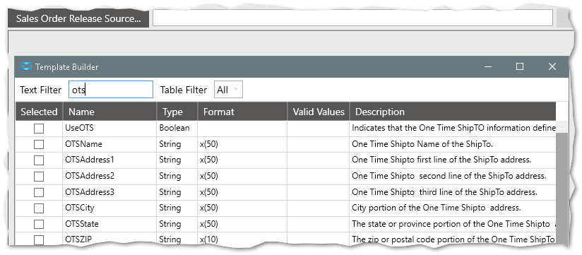

You can use DMT to create the releases.
I would manually make the order with the line (which would create a single release). Then use DMT to create the releases. I’d just use the “Sales Order Release” upload, and not the “Sales Order Combined”. There is a ShipToNum field you can use to match the ShipTo’s you created.
One word of advice… If you change the shipTo on the header or the order line, it may overwrite the Release’s ShipTo’s.
Edit: Or skip making the ShipTo’s, and use the One Time Shipto fields in the Release upload.

Thank you for your help on this. It took a while for our customer to nail things down with their end-user. I did use your edited solution and used the OTS on the release as the addresses could change over time if we needed to repeat the shipment. It took about fifteen minutes of playing with DMT in our test database to nail down what was needed and then I was able to enter the order and upload the releases in less than five minutes. I appreciate the help this user group provides!

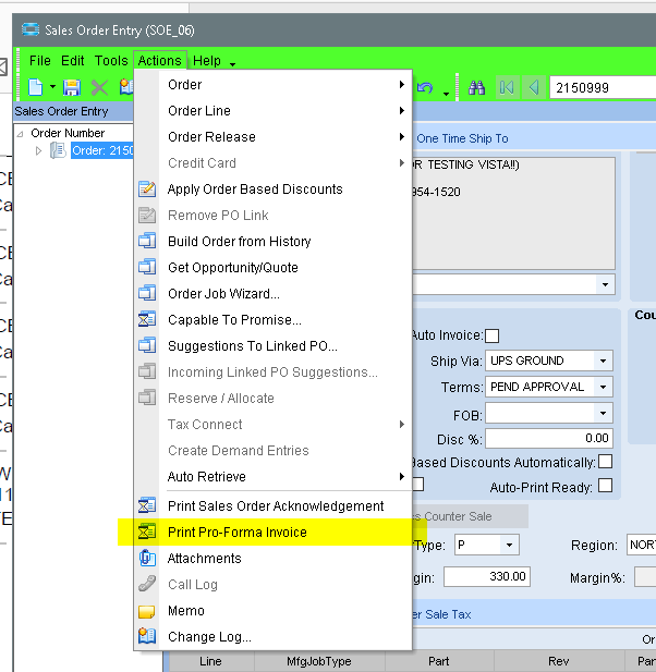

My problem is that I was going to bogart the proforma and create a new style and call it invoice, but it’s for the full 115 and I only need it for one.
This would need to be done off the Packing Slip and not the Sales Order, since they only want to know about what’s shipping. Long ago (in E9) there was an actual Commercial Invoice report (in Crystal) I modified… I haven’t seen it since (it may have come with Insite Manifest).
There is a checkbox under Company Configuration > Modules > Materials > ShippingReceiving labeled “Calculate Prices”, and marking this as TRUE will display prices from the Sales Order on the Pack Slip. With a time-consuming procedure you could enable this field, modify your current Pack Slip form to remove the pricing field from displaying, and create a new Pack Slip titled “Commercial Invoice” that DOES display the price.
