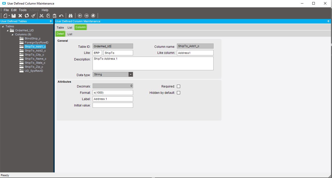

I am trying to Map ShipTo Address–>Zip code into OrderHed table as an Custom field. I have everything entered, but I am not sure how to get the mapping to show where to look for the data. When I go into UD Column Map and click on target, nothing populates. What am I missing?
You want the OrderHed.Myzip_c filed to be set to the ZIP of the ShipTo entry selected on order header?
Yes. The ShipTo in the Order to show up as you stated.
So, I changed the Like Column to match the label in the ShipTo and tried to save. I received the error:

On the Data Type, should it be SysName instead of String?
You’ll have to make a BPM to populate the UD field. The BPM will also allow you to add what ever logic you need in determining how to set it. For example, should MyZip_c be set to the SHipTo.Zip only if it was previously blank? Or anytime it is different.

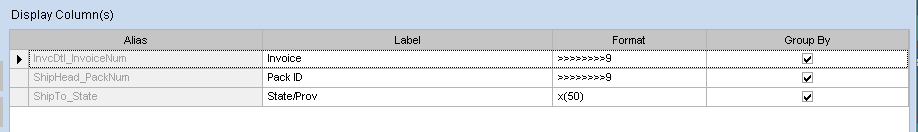

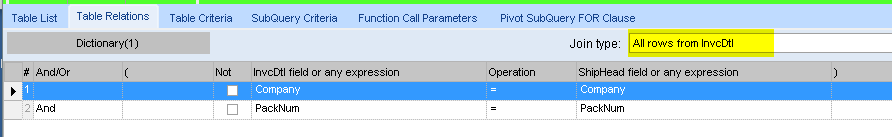

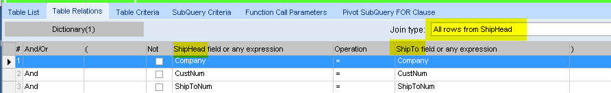

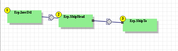

Here’s a simple BAQ to return the ZIP code and state of each Invoice lines ShipTo
InvceDtl to ShipHead table relations
ShipHead to ShipTo table relations
Display Columns
edit

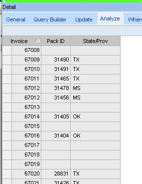

It will produce Invoices without ShipTo Info (for Misc Invoices)
You’ll probably need to tune it for things like credit memos too.
