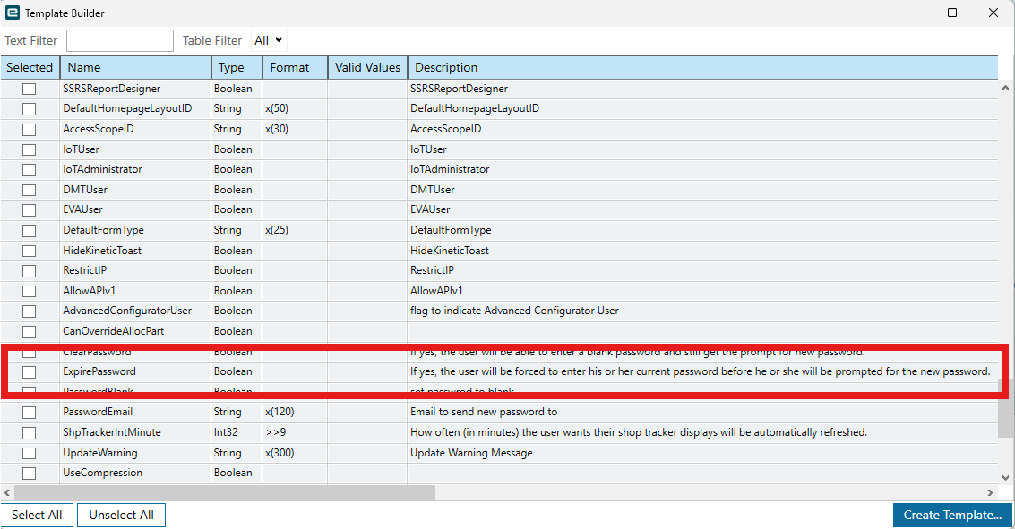

Yes we do, is there a way to password reset via DMT?
bderuvo
(Bryan DeRuvo)
March 2, 2026, 7:21pm
4
Not that I know of, but you can try to disable the account and re-enable, that will force a password reset.
There is an expire password checkbox in the DMT Template Builder for User:
I have not actually done it but I would expect this to work.
