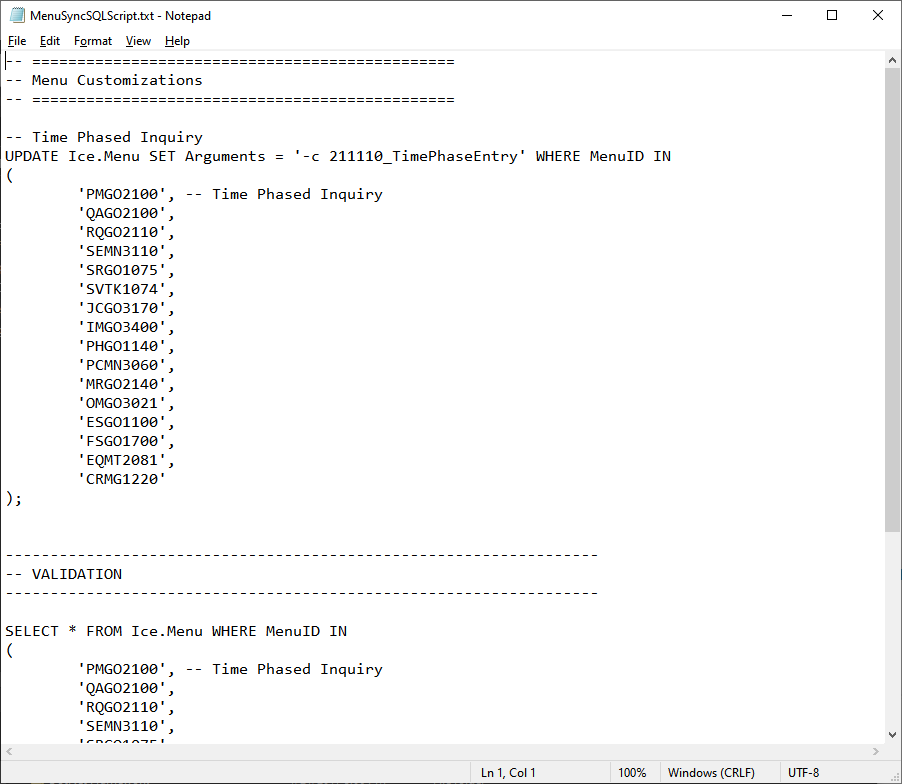

The way we do it is via direct-sql only for Arguments and Personalizations those are our only SQL Exceptions (on-prem) because Solution Workbench has errored out before when the Menu Existed, instead of an Update it tried an Add and im not sure if Epicor fixed the bug in 10.2.700.
What we do currently on-prem:
You can also include the SQL in your .cab and then it will be available via Admin Console to be executed.
