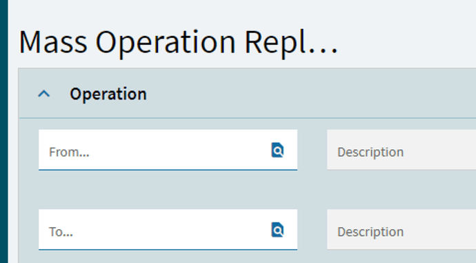

Operation ID length up to 8 characters but when I type in the Mass operation it supports only 5 characters and it’s difficult to search for us. Can we write this to EpicCare

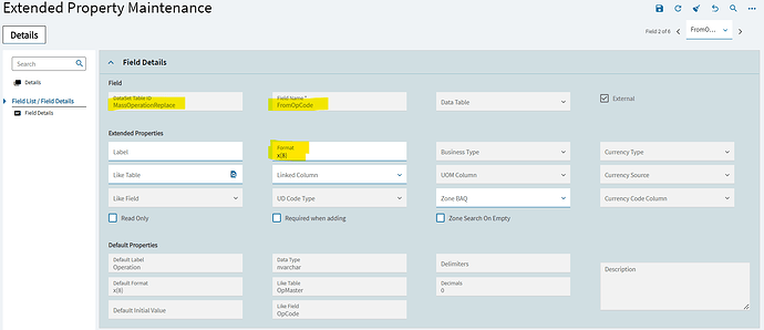

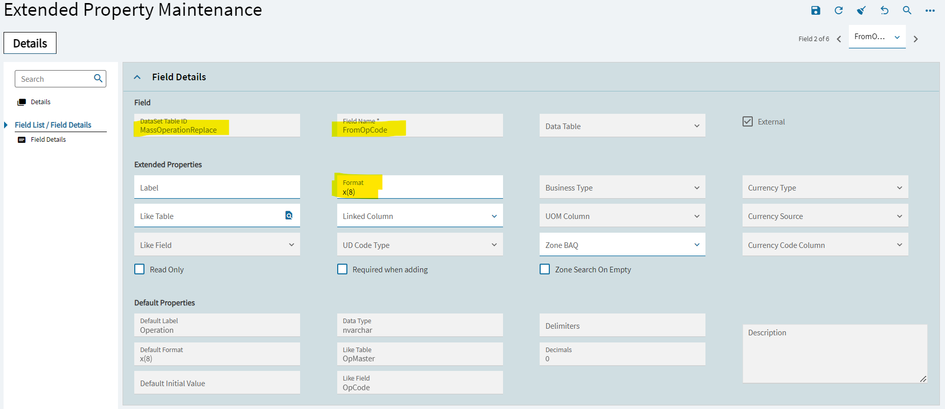

Change below in Extended Properties and it will allow you the same.
Thanks, Fakhruddin. It worked.
