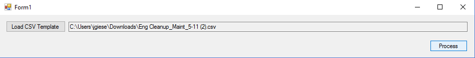

I don’t have it anymore but it was pretty simple. I took my DMT template, looped through it and used REST calls to remove the resources I didn’t want.
