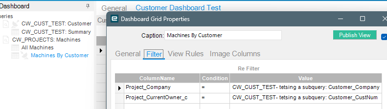

I’ve added buttons that use dataview-filter-set to override the filters on the dataviews (filter by customer or not), and I tried set-title to update the top title as to what’s happening:
I’m setting the filter in the filer by company to:
(CW_PROJECTS_1_0.Customer_CustID=CW_CUST_TEST_0_0.Customer_CustID) and (CW_PROJECTS_1_0.Project_Company=CW_CUST_TEST_0_0.Customer_Company)
(similarly “Show all” button sets the filter to empty string)
Sorta works: ie if I click filter by customer, it does indeed filter by the current customer, but if I then select another customer, the projects don’t change unless i click refresh on the bottom grid .
If I set the customer filter in the dashboard itself, then the bottom grid updates as i change customer. But if I set the filter via dataset-set-filter, it doesn’t ? I’m sure that earlier today it was dynamically updating when I selected another customer…

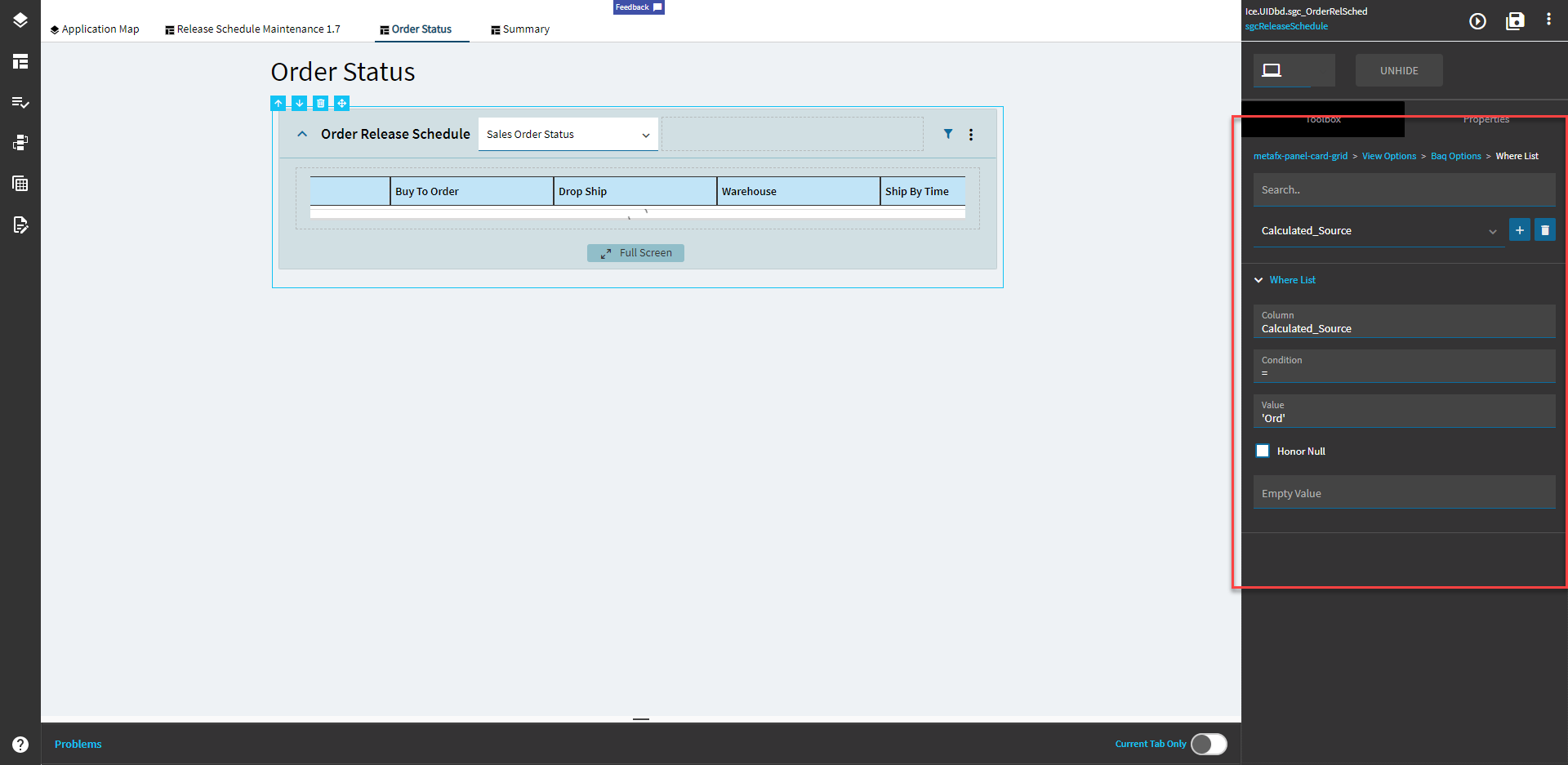

For the filtered views, you should use the View Options for this.
No need to use JSON; don’t let the default brackets scare you off.
Thanks Hannah, nailed it. I added extra grid views into the dashboard and bingo they miraculously appear and work as expected:

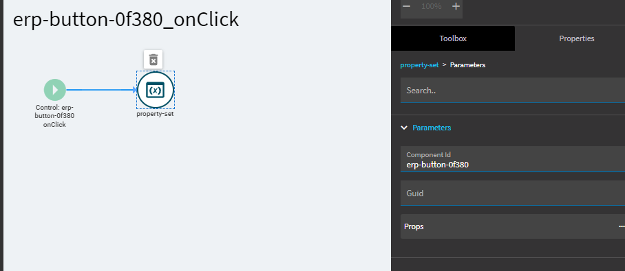

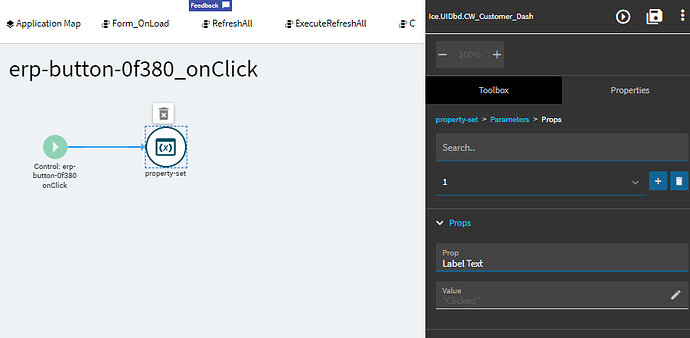

I’m still having issues with property-set, in my trivial exampIe click a button and change the button’s caption to “clicked”:
Click it…
image… but the button caption doesn’t change.
At least I’ve discovered the debugger! :exploding_head:
The property is likely wrong.
Try one of the following:
LabelText
labelText
label
text
Etc.
I don’t know what it is off the top of my head, so you’ll have to play around.
I had tried several combinations, and had about given up when I came across your post on debugging tools, could see from looking at the elements and their properties that its labelText :+1: Property names appear to be case-sensitive also, which I didn’t previously appreciate.
