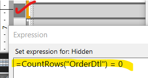

In the main PackSlip form, I created another Dataset- (I called it OrderDtl )
My query in the dataset-
=“SELECT T1.OrderNum, T1.LineDesc, T1.PartNum, T1.OrderQty, T1.OrderLine, T1.OpenLine FROM OrderDtl_” + Parameters!TableGuid.Value + " T1 WHERE T1.OpenLine =1 AND T1.KitFlag <> ‘C’"
Then on the row visibility of that open lines subreport, I check if there are any rows.
