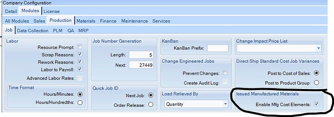

Do you have the Enable Mfg Cost elements checked in company configuration?
Without this checked the “materials” of higher assemblies is all of the costs of the lower assemblies.

I couldn’t find the Mfg Cost check box, could you help me where I can get my hand on it, please?

Checkbox
