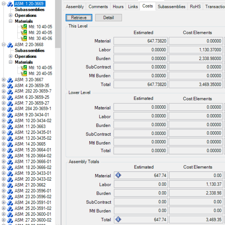

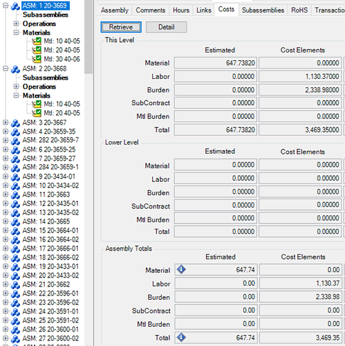

We are running a job with alot of subassemblies. We’d like to track the individual costs of each subassembly. The subassemblies have been completed and material has been issued to the job however, the material category of the cost elements reads zero. Any suggestions on what we are doing incorrectly?

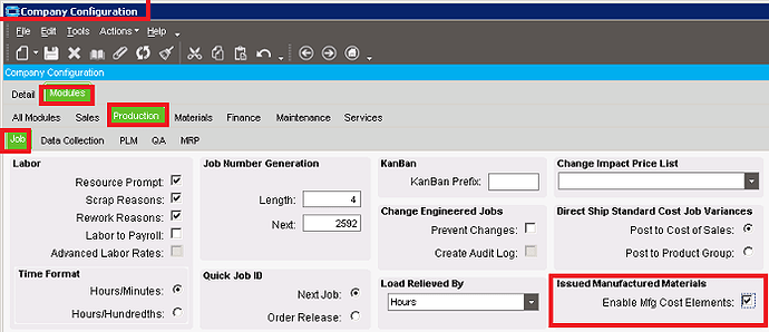

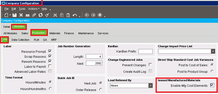

And one thing I always look at - “Enable Mfg Cost Elements” checked in your Company Config. (And the Tech Ref Guide gives a good explanation of what it does).
