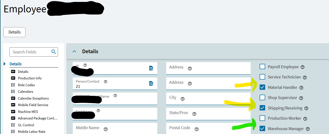

I could be wrong but…on the employee record, I think one/both entries (depending upon user) in yellow are probably required for MRQ and the green for MQM.

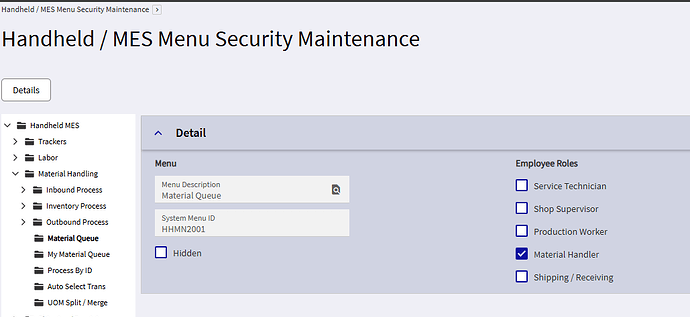

That is controlled VIA MES Menu Security Maintenance
so between the two of us we threw out a couple of leads…hopefully it helps
Both Material Handler and Shipping/Receiving are checked. Not concerned about MQM for these particular users, but I’ve certainly made note about having Warehouse Manager checked if that ever changes.
Dadgum it. Oh well…thought we were getting somewhere. :frowning:
