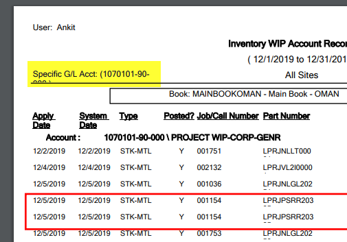

In inventory WIP report , You can see that
  1. First Transaction is Material Issued
  2. Second transaction after revenue reorganization
  3. Third transaction is returning the material
  4. After revenue reorganization fourth entry is missing which will reverse the project cost.
Two things
  1. The lines you highlighted (red box) say for job 001154, the Prod Detail says 001153.
  2. In the Prod Detail the legal numbers show different site (mfgsys for the issue, and RUS for the return)

I would look at the Part Tran History for the part to verify the transactions happened the way you expected them to. Include the SysDate, to make sure that its not a back date transaction.
Also, on the WIP Recon, you have it filtered to just one GL Account.
Maybe the return hit other accounts. If you can find them it might help you figure out why.
