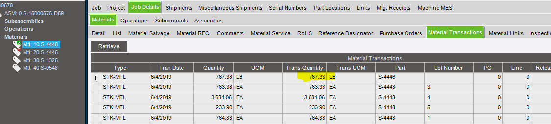

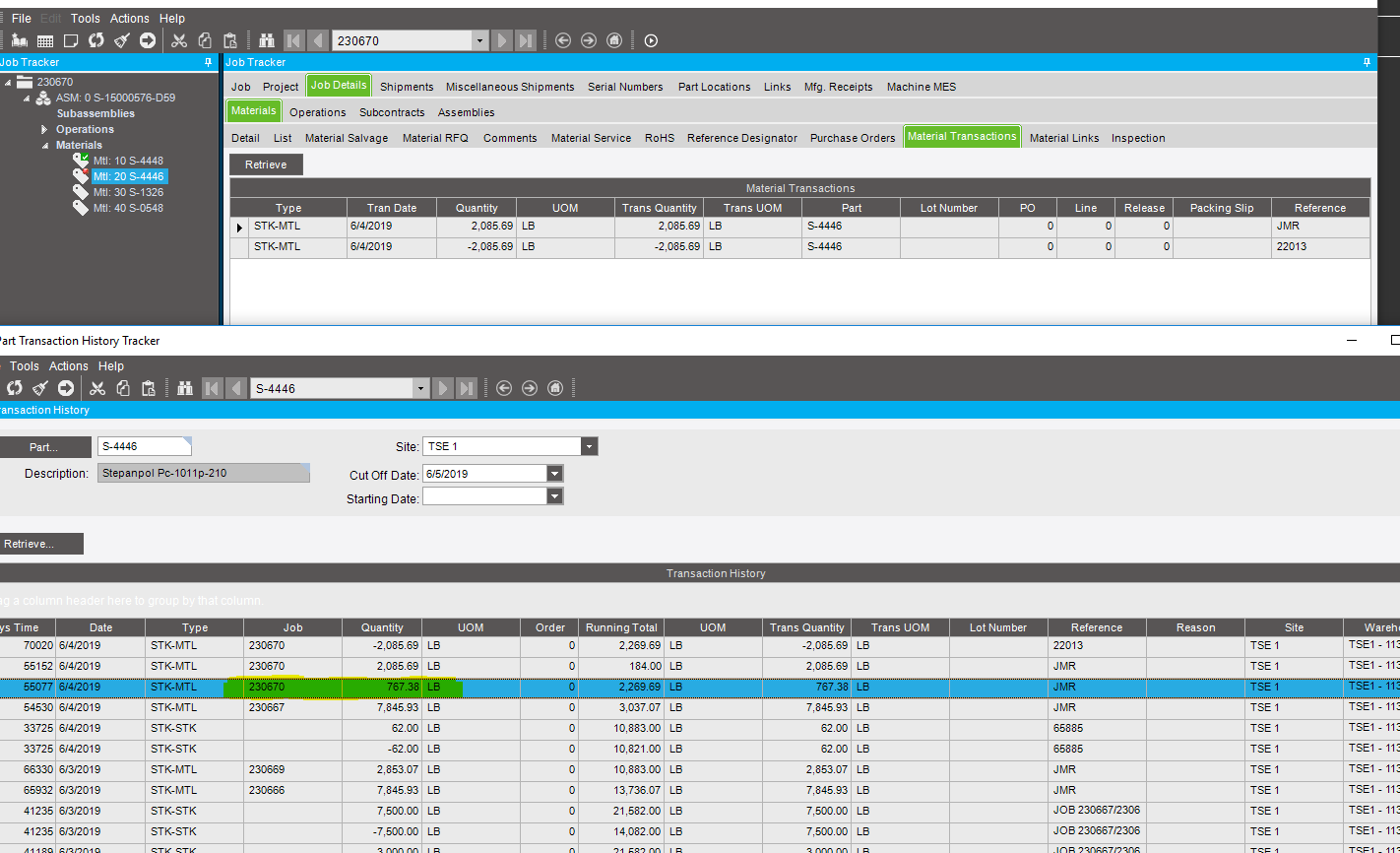

This is an odd one. In part trans history you can see material being issued to a job. But in Job Tracker it does not show up. Any Ideas?
Did that same part number get issued to a different material sequence? The part numbers don’t have to match. It’s that way to facilitate substitutions.
