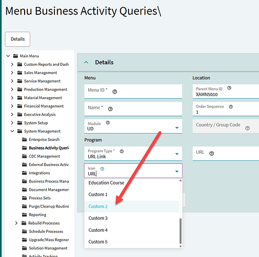

I have the option for custom menu item icons, but where do I go to see, edit or add new ones in Kinetic 2026? This is more of a general curiosity than a must have.
d_inman
(David Inman)
September 2, 2026, 3:50pm
2
Looks like from this thread that it might be on the app server:
Check out resource manager in your tools. Not in front of my computer, but there is a tool in the utilities folder on the app server that allows you to extent them. I’m sure there will be a custom resource that represents the menu icons. You should be able to change it here, if I am not mistaken. If I am then I’d like to know too
I stand corrected. The Utility is the Resource Editor.
The resource file is found in the config\res folder of your client. You can override the ba…
