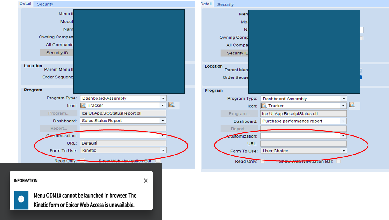

I opened our customization menus in the web version. Most of the menus opened well. But, only a few certain menus did not open. So I looked at the menus that wouldn’t open and noticed a difference between them and the ones that did.
Most menus have the “From To Use” field set to “User Choice”, but the menus that don’t open have the field set to “Kinetic”. But, when I created all these custom menus, I created them in the same way.(BAQ → Dashboard → Menu Creation). And this “From To Use” field was not an option I could select.
Why did this difference appear? And is this the reason these menus couldn’t be accessed in the web version?

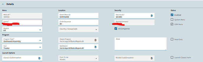

If it’s a supported app, you may need to pop into Menu Maintenance and configure it to open as Kinetic. In Kinetic Menu Maintenance, check the “Kinetic” checkbox. Then click the search on “Kinetic Application” and select the relevant app. If it populates a URL value, you’re on the right track.
Even if it’s a custom dashboard, it’ll look something very much like this. Same for SSRS reports, and those sometimes need another step but it’s been a while and I can’t recall that precisely off the top of my head. Something like Report Style → one of the window menus (‘tools’ I think?) and something like “generate form”.
If the browser client is nigh for you as well, it’s worth the time to audit all menus. Get a complete list, filter where “URL” is blank, and investigate those. I had to fix a lot of stock menus.
As you can see in the screenshot above, the menus marked “User Choice” and without URLs, like the one in the right screenshot, appear correctly. However, the menu marked “Kinetic” does not appear. That confuses me even more.

Check in Kinetic Menu Maintenance. Classic Menu Maintenance hasn’t received the same updates.

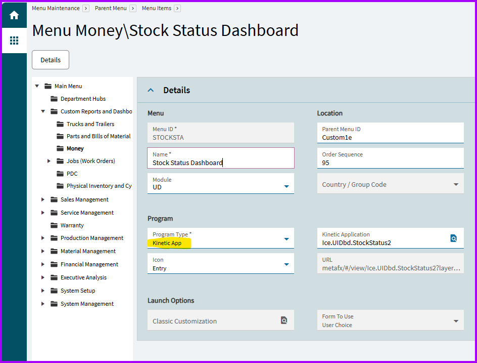

This may or may not help, but I’ll take this at face value - you want a dashboard to open in Kinetic in a browser, right?
So, my advice is:
  1. Build it in Application Studio or convert it, but somehow “Kineticize” it.
  2. Add to menu as a “Kinetic App” - see pic below.
I didn’t see anyone offering that advice about the “Kinetic App.”

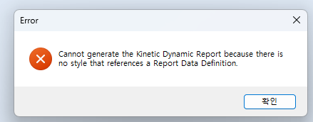

When I ran “Generate Form” in Report Style, I got a pop-up like below. Is there anything else I need to do?
What kind of report is it?
This method is for reports based on an RDD. Is it a BAQ Report or some other kind of report?
it’s a BAQ Report
Then do the same in BAQ Report Designer.
