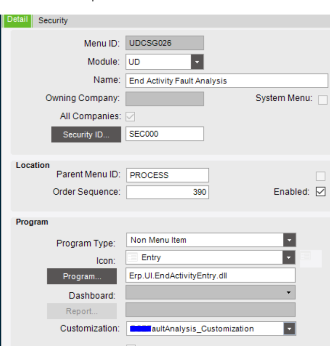

Add your fields and bind them
Save the customisation
Create a new menu branch in process that references the end activity screen with the customisation populated

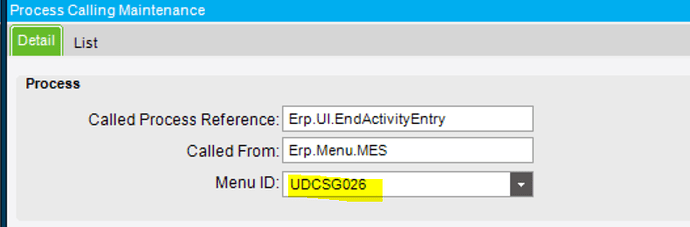

Open ‘Process Calling’
Enter the menu id against the process

Many thanks for this.
Done and working as described.
