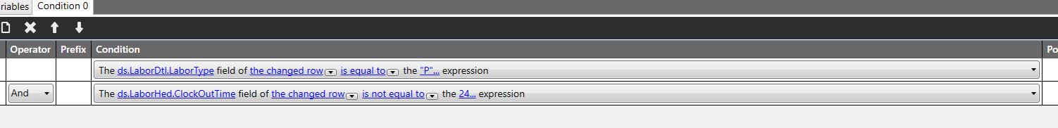

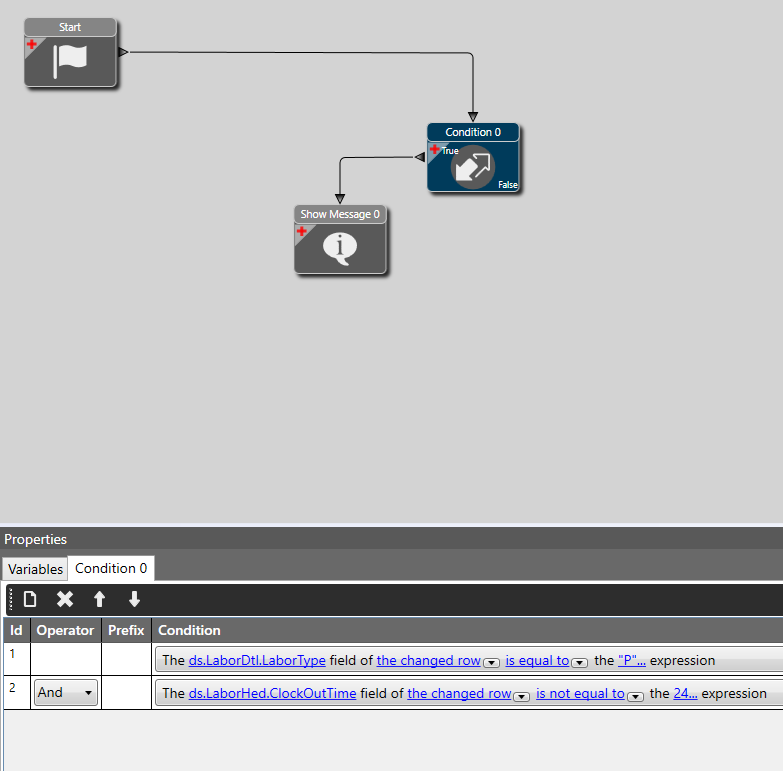

I am trying to add a message as people end their activity on MES. I made a method directive on ERP.BO.Labor.Update. It’s a Pre-Processing directive where I added two conditions.
  1. The LaborDtlType is so that the message only displays for when the employees are in Production, not setup or idle.
  2. The ClockOutTime is to ensure that the Employee is clocking out, changing the time from 24 to the actual clock out time.
The flow is if these two conditions are true then a message should appear to the employee.
However, I am getting nothing. Any ideas?

I’ll try changing the condition from Changed Row to Updated Row and see if that makes a difference. If that doesn’t work, I’ll remove the condition entirely and test again.

If you haven’t got this sorted yet. Just try the condition and build it up…
First with no condition, then add the first condition, then the second.
Just testing with a message first is how I do it when I can’t get something to work how I expect it to.
That is exactly where I will start. Last two weeks have been crazy for me so I have not had any time to mess with it.
Ok so good news is that without a condition it works fine. I guess I will have to mess with the condition statement. I don’t want it to pop up every time. Just when an op is set to complete.
Got it to work. Issue was the condition was originally set to “Added Row” when it needed to be “Updated Row”.
