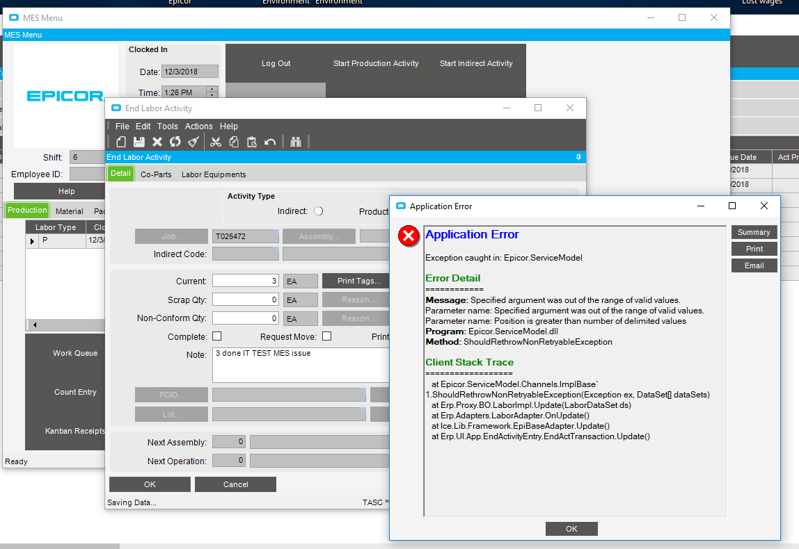

We just went live on 10.2.300.5 and we have a an error on a job when ending activity.
Previous Op completed in full
Current Op only has a few done, still plenty to work.
Mtl all issued.
thoughts??

Does it let you end activity with a 0 for a quantity?
Remove job from schedule – add job back and reschedule – see if that fixes it
yes it does; I can end acitivity with Qty 0
then what @bw2868bond said is what we’ve had to do to fix that.
Yup that fixed it. Reasons why that happens?
I think it has something to do with operation dates getting messed up. The more we mess with jobs that are in process the more that error shows up. I think it’s just something that doesn’t get updated correctly when things are getting moved around. If you just went live and DMT’d a bunch of stuff in, I would think that’s part of the reasons it gets messed up.
