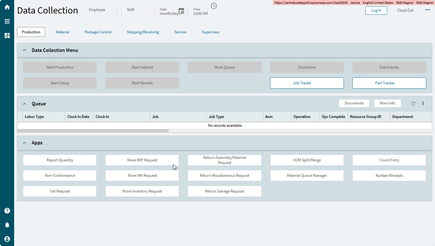

IIRC using =MES uses the full client license while =DC uses the MES “Data Collection” licenses. URL ends like: …/apps/erp/home/#/home?mode=dc once the user logs in it should show them then DC homepage:

It doesn’t if you haven’t been logged into Kinetic previously in my experience. If I go to mode=DC first I just get the DC app.
Odd as I was logged into full Kinetic and opened my URL for =DC and got the MES home page once I got through the login…
I tend to load the mode=DC URL in a different browser (if im normally doing using chrome, ill use edge) - or private mode. The cookies and whatnot tend to crossover between sessions if you use the same browser.

Try an incognito window with mode=DC

So you are saying that if your clear the browser cache and start fresh or us an InPrivate/Incognito window and load the DC URL it does not take you tot he MES screen?
Maybe try clearing your browser data for your Epicor SaaS endpoints. Then try again. I’m wondering if Edge is still caching too much data and it’s redirecting incorrectly.
INCOGNITO for the win!! Thank you!
If that works then I would bet that there is a caching issue that is holding onto the previous session.
We use Edge and have a GPO setup to clear the cache automatically on browser close for our App Servers (we are on-prem so I actually think we clear anything with our AD Domain) and that solved a number of the random weird issues we would get when we made the move from Classic to Browser-Kinetic.
That’s why I mention Incognito here.
