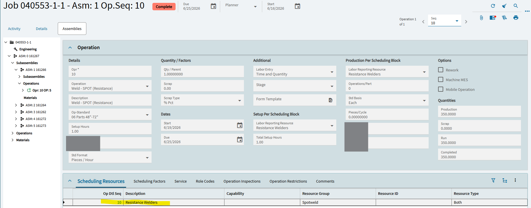

Same employee, same date, same job, and same clock in time. Different resource group. But notice that it is for the same Asm and Opr. We only have one scheduled resource for the operation.
I have only looked at the last month of data. This issue existed before the update to 2026 and after the update. For approximately 10,000 labor transactions this issue is hitting 72 times. There were also multiple people that worked on this same job, assembly, and operation. None of the other transactions had the same duplication issue.
