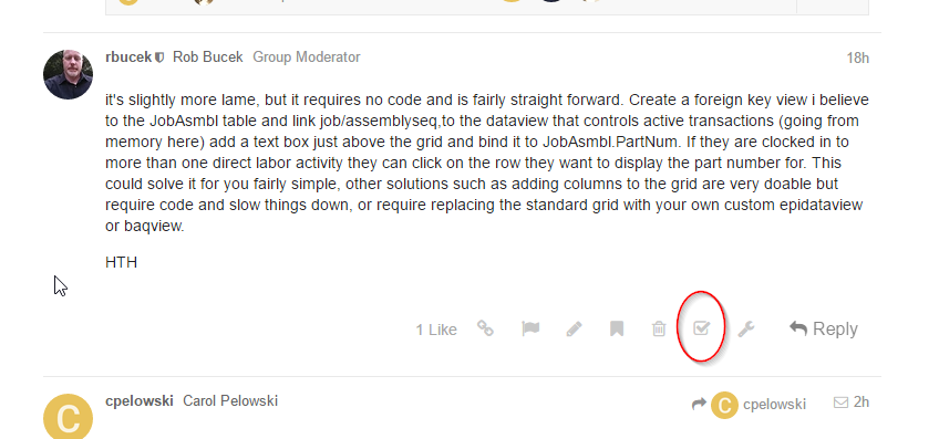

Near where you have the like (heart) and reply there is a checkbox icon.
Thanks Chris,
The reason I wasn’t seeing it is because I was just viewing the responses. I guess it helps to Log In … (Geez … you would think it was a Monday!)
