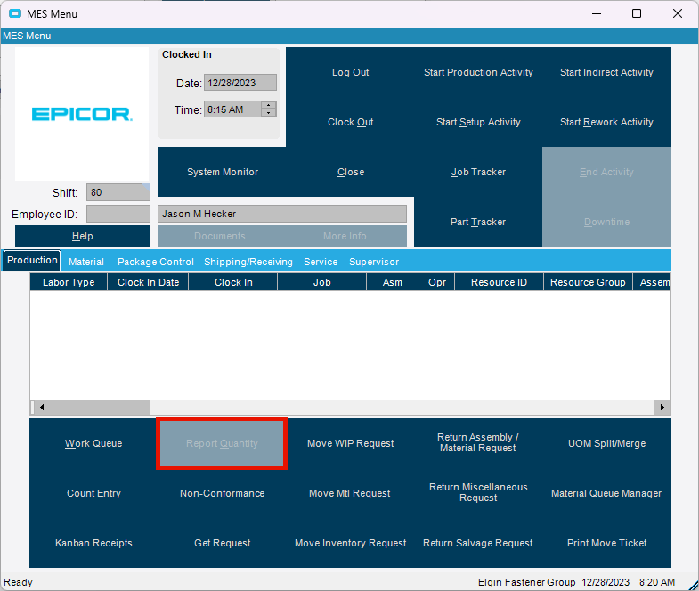

The “Report Quantity” button in MES is disabled if the user is not logged into any Production Activity. According to Epicor Help, that is the intended function.
However, I have a user reporting that the button is never disabled for them, and they use it constantly. That user has requested that I give permissions to another user for the same functionality. I have set that other user up with the same permissions on both the Employee and User level as the 1st user, and the button remains disabled unless there is Production Activity.
There are no customizations on MES that refer to this button. The only customizations done are adding custom launchers for the 2 buttons on the Production tab (the 4th button in the 1st and 2nd rows). There are no BPMs for Erp.ReportQty.ReportQuantity…I can find nothing that would allow this to work for user 1, but not user 2. The ReportQuantity Service Security is also set for “All Users”…

The end user just sent me a picture of her MES screen, and I hate to say that I am officially stumped…her Report Quantity button is 100% enabled, and she is not logged into any job(s).
