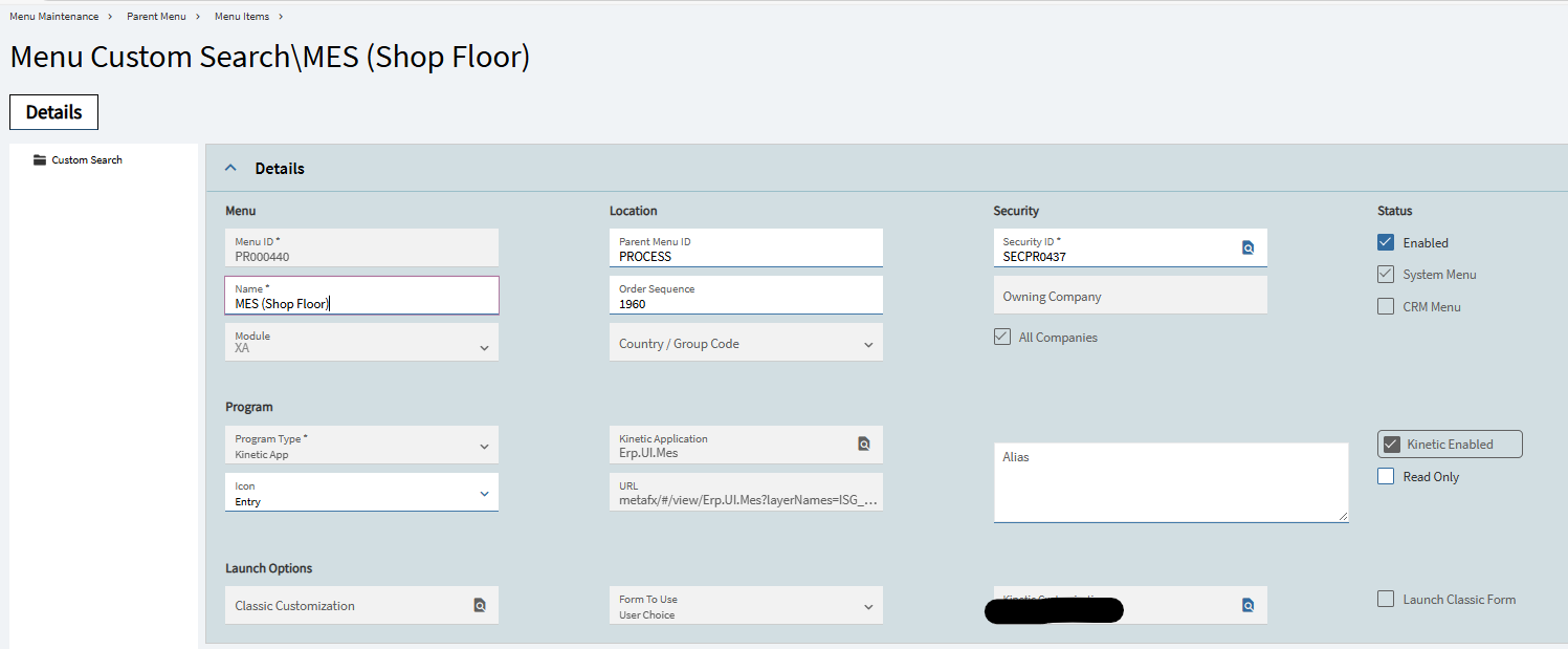

Looking at MES, under the supervisor tab, Order Tracker is an option, since it is there you should be able to add it as button under one of the other areas and it should not consume an elevated license as I originally said (I still think Entry does but have not tested recently to confirm).
How familiar are you with customizing screens in Application Studio?
I have done a decent amount of Application Studio work, but I am far from an expert. Can I simply open the MES screen in Application Studio and basically borrow the Order Tracker button from the Supervisor tab and place it on the main tab?

I’m not exactly sure what you mean when you say ‘borrow’ but I would create a new button in the area you want it, set it up identically (including creating any event if needed). You will also need to look into the row rules and use one of the buttons in the area you are in as a guide for when the button is disabled/enabled (employee logged in with access to that area).
OK I have the button created and testing seems to work.
How do I apply that layer to MES? I am used to updating menu links with appropriate layers, but as MES is a distinct URL I am not sure how to do that.
Essentially it is the same process but MES lives in the Process Menu, not the Main Menu, if you do a Search through ALL in Menu Maintenance for Menu Description Like MES you should find it, from there you should just need to apply the customization like normal:
OK Epiusers I have a working version of MES that has Order Tracker = YAY!

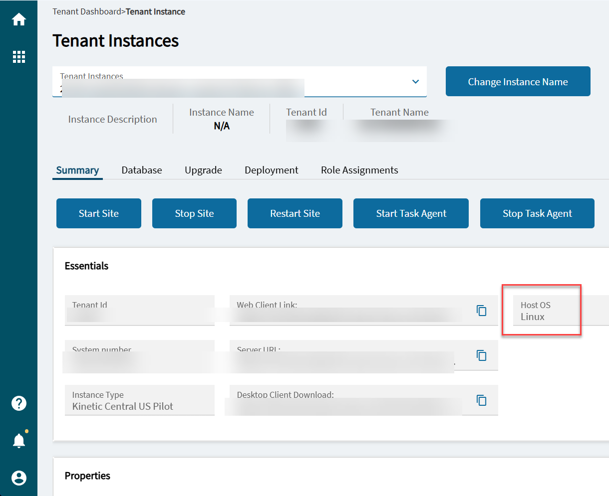

What version of Epicor are you testing? Also are you running on a Linux container?
You can tell if you’re on Linux container in the Cloud Management Portal:
@Randy THANKS! I’ve been wanting to figure out if we were on linux yet or not!
We are on linux and the version is ERP Version 12.1.100.10 in Cloud Management Portal. Or Kinetic Version 2025.2.10
