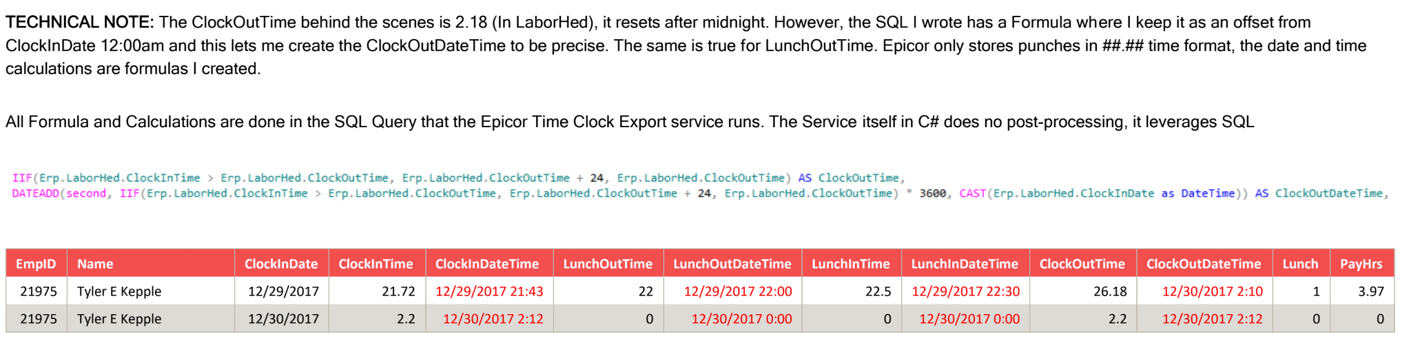

You can solve that easily in a Dashboard / BAQ or even add an additional UI Field and calculate the date.
DATEADD(second, Erp.LaborHed.LunchOutTime * 3600, CAST(Erp.LaborHed.ClockInDate as DateTime)) AS LunchOutDateTime,
IIF(Erp.LaborHed.ClockInTime > Erp.LaborHed.ClockOutTime, Erp.LaborHed.ClockOutTime + 24, Erp.LaborHed.ClockOutTime) AS ClockOutTime,
DATEADD(second, IIF(Erp.LaborHed.ClockInTime > Erp.LaborHed.ClockOutTime, Erp.LaborHed.ClockOutTime + 24, Erp.LaborHed.ClockOutTime) * 3600, CAST(Erp.LaborHed.ClockInDate as DateTime)) AS ClockOutDateTime
Since I add + 24 to Epicors ##.## if the ClockInTime is less than ClockOutTime (indicator that it reset to 0). I get a result such as “ClockOutTime 26.18” then I can times that by seconds and convert to an actual DateTime. That should cover up to a 23.9hr shift (which is not something normal people do).
