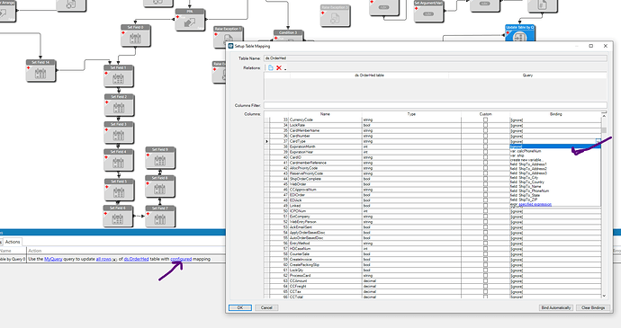

Its really simple, when you set up the table mapping the drop down will include variables, in addition the the query fields.
Oh, and perhaps this will trip you up. The variables you declare in a custom code block are local variables and only accessible in that code block. You’ll want to define AllSerialNumbers in the Variables tab at the bottom of the BPM window, and then in your code delete the ‘var’ in front of AllSerialNumbers in your code block.
