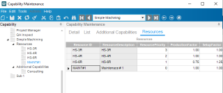

I have been working on a simple method directive for the Capability object. Not used by many (APS required I believe), so probably not a lot of directives on this one. The capability object has the main dataset wtih a description, and then two datasets: resources and additional resources. The user wanted to see the resources in the description so it displays in the various methods (Revision, Job, etc.). Cool. I’ll just read through the resources dataset and concatenate the resource ids, and update the description on every method update. Rabbit stew coming up!

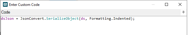

If I dump the dataset as a JSON blob:
I get this on an update method:
Json

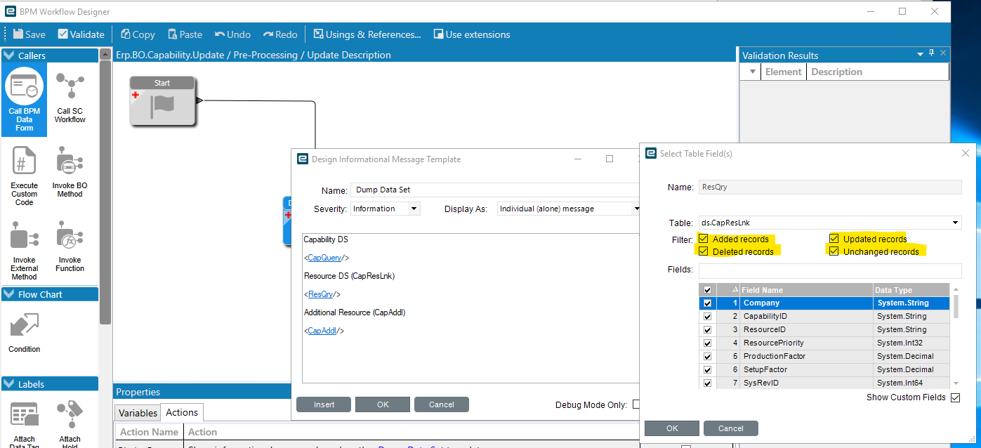

If I create a display widget and put a simple table query to show all resources, it’s blank - even though there are resources on the screen. :thinking:
Which outputs this in a message box:
Capability DS
Company,CapabilityID,Description,Inactive,PrimaryResourceGrpID,AdditionalResourceRequired,SetupGroupRequired,CapType,OpCode,OpStdID,SysRevID,SysRowID,ExternalMES,BitFlag,OpCodeOpDesc,OpStdDescription,PrimResGrpIDDescription,RowMod
EPIC06,Simple,Simple Machining  ,False,HAASHOR,False,False,B,HORMACH,,382626,25013fba-ad49-49f3-b577-a33b015bfe04,False,0,Horizontal Machining,,Horizontal Haas Machines,U
Resource DS (CapResLnk)
Company,CapabilityID,ResourceID,ResourcePriority,ProductionFactor,SetupFactor,SysRevID,SysRowID,ExternalMESSyncRequired,ExternalMESLastSync,BitFlag,CapIDDescription,ResourceDescription,RowMod
Additional Resource (CapAddl)
Company,CapabilityID,CapAddID,Description,ProductionCap,SetupCap,SysRevID,SysRowID,ExternalMESSyncRequired,ExternalMESLastSync,BitFlag,RowMod

So in my case, I have the capability. I add or delete a resource. The update method runs. I will only get the new line but not any existing lines . I would have to look up the current object and do the same work as the base class (add or delete) to calculate the new description.
