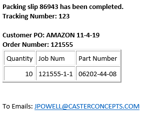

This is what we get without the line:
There should be another line, above the tracking number that displays who the carrier is. Any one have any ideas on why this would cause the trigger to break?
Never mind, I figured it out. Sorry, noob mistake. It’s not a bool, it’s a string. Spotted it right after I made the post.
Had to change that line to:
sMessage += string.Format("<b>Carrier: {0}</b>", ttShipHead_xRow.UDField<string>("CarrierLabel_c"));
