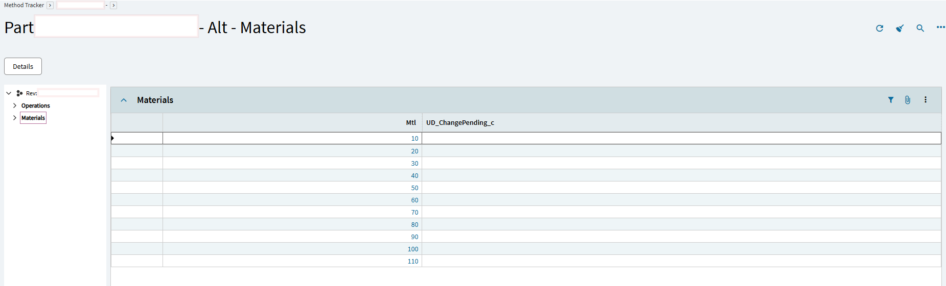

Below is the location of where I am trying to force the update of data (This is within the Materials section of Method Tracker),
Happy to provide more context or information if required. We haven’t had any problems with other Menu’s, it’s just been Method Tracker so far.
