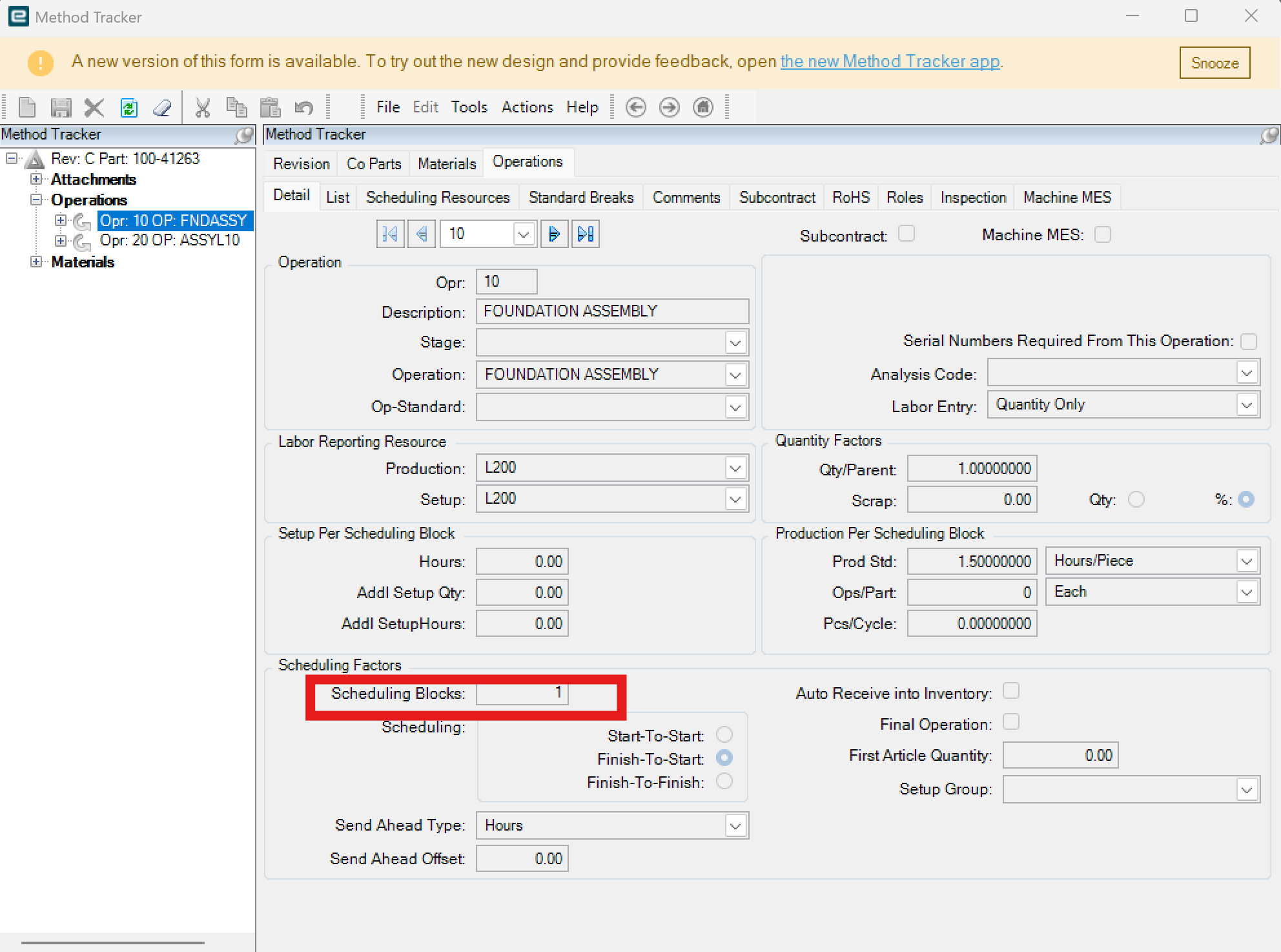

We have an issue with our Methods where we need to change the Machines for other operations. I have DMT’d to the Bill of Operations, but when I open the operation in Method Tracker, the data hasn’t changed. Am I hitting the incorrect destination for updating?

Unfortunately, no. The part does not remain checked out. I’m still digging around to find where I can get this changed manually as well to help track down the DMT I actually need.

Sorry, but have to ask… Are you looking at the same Rev that you updated via DMT?
Haha, totally valid question to ask, but yes, same rev!
Just as an update here, apparently using the matching ECOGroupID is a no no. If I just created my own ECOGroupID and used that, everything checked in as intended. Thanks!
