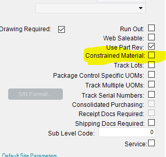

So we heard you need to check the “Constrained Materials” check box for the longest lead time part in the BOM. In my opinion that is crazy. Our BOM’s constantly change and so do lead times. Right now for us they will be better off manually setting the Lead Time for our top level part.

Our “constrained material” is already checked and still get same results. :frowning:

Here are the settings i use, Note you have to mark a part as a constrained Materiel ( In Part Maint) for the scheduling engine to consider the lead-time ( except when the items is purchase non-stock it will use lead-time by default, unless Ignore Constrained Materials is selected in MRP)
this is a real headache…ours was permanently on 6 days mfg lead time for a part which we knew was wrong…i drilled down to one of the items in the BOM which itself was above 6, went to part entry unticked “constrained materials”, saved…then ticked it again and resaved.
Then re-ran mfg lead time calc…and hey presto its now more than 6 days!!!
So, its almost like the part was visible as ticked, but the database itself wasn’t? if that makes sense?
