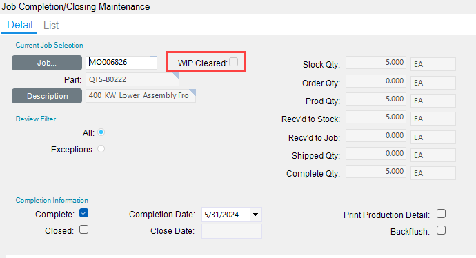

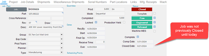

As you can see on the Job Closing screen, the job is not Closed, only Complete.

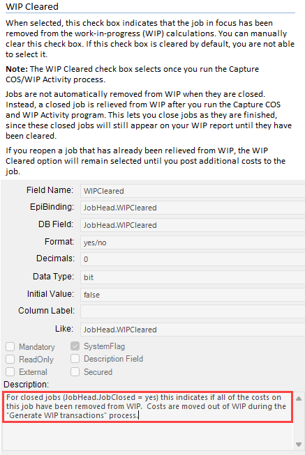

What does the WIPCleared flag on the JobHead records look like? If it’s true, then the job was previously closed and someone reopened it.
WIP Cleared = False.

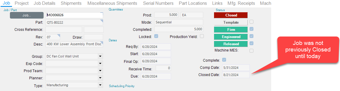

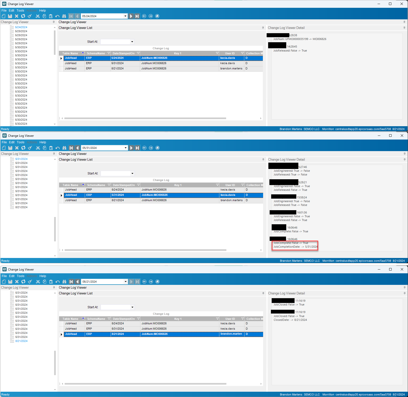

I have a change log on that table. The Job was never closed. You’ll see where I closed it today 8/21, however before that, it was never closed.

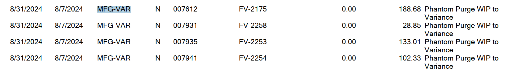

I am working on this also today and the mfg-var that I see before I close the job is phantom purge on the wip recon and then purge after capture.
KB on phantom purge
https://epiccare.epicor.com/epiccare?id=epiccare_kb_article&table=kb_knowledge&sys_id=62caf726db9b67007a572a9b8a961934&searchTerm=phantom%20purge
@gpayne took my next question. Are they showing on the WIP Recon report as a true variance or a phantom purge?
Everything we see on the WIP Recon report is Phantom Purge WIP to Variance.

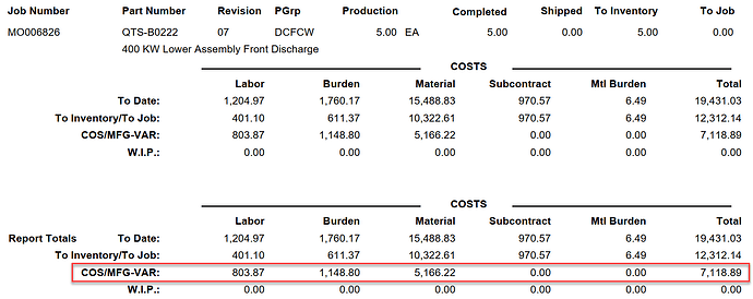

The WIP Recon report is ESTIMATING what would happen if the job was closed. The transactions have not happened yet and will not happen until the job is closed and WIP is captured.
Technically, you could un-complete the job, reverse the job receipt to inventory, and then receive the job to inventory (again). If you run the wip recon report again, the variances should be gone.
Nothing posts until you run the capture process. Everything is theoretical until that is done. You can even mark the job as closed and nothing will post, everything will still be theoretical. It is the capture process that posts everything to the GL.

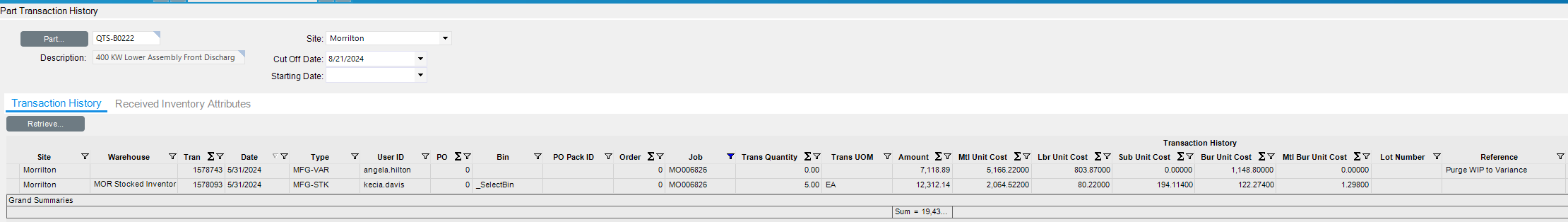

Job MO006826 was relieved to Inventory on 5/31. However cost were added after the Job Receipt to Inventory.

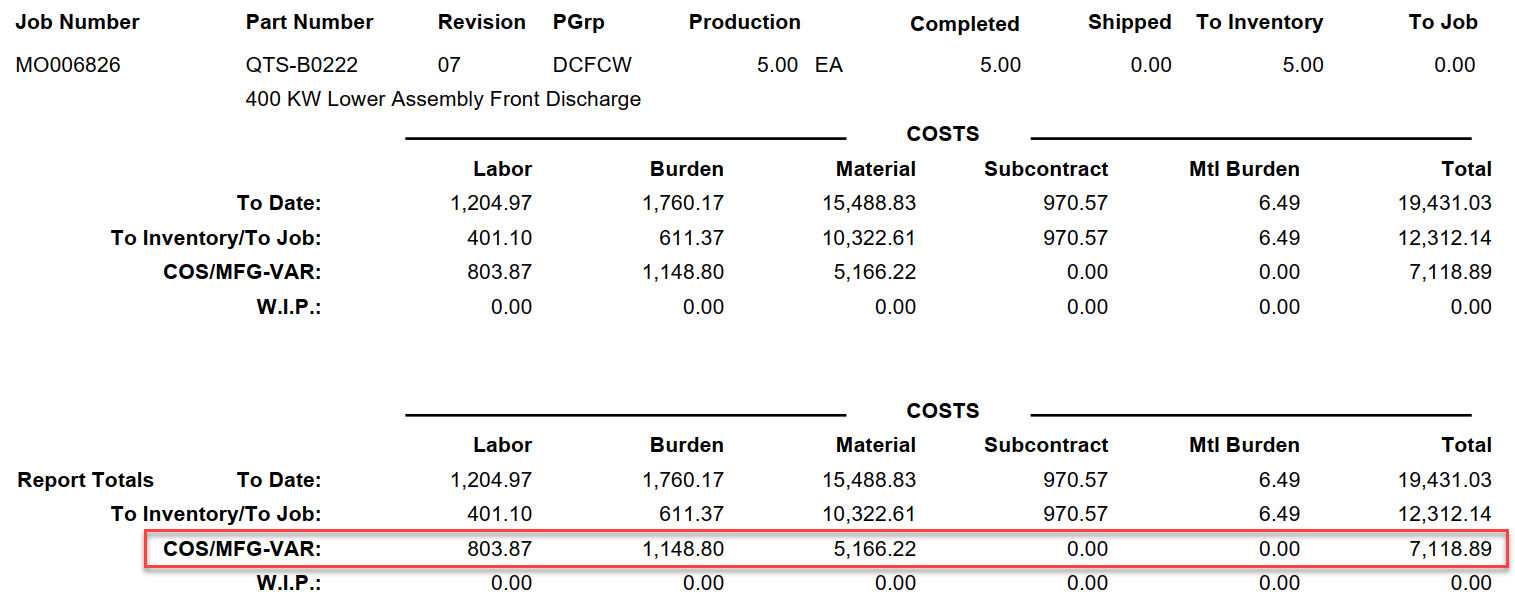

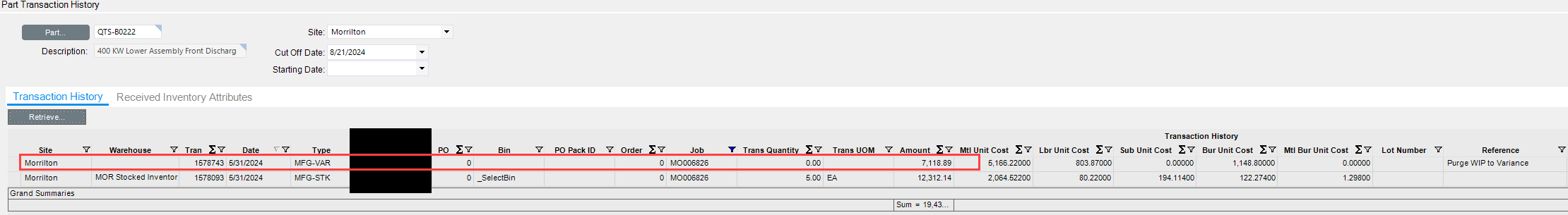

the Work in Process Report Show $7,118.86 has been sent to COS/MFG-VAR.
The Job was marked Completed and not closed until today. I checked the Change Log for job Complete > Closed.

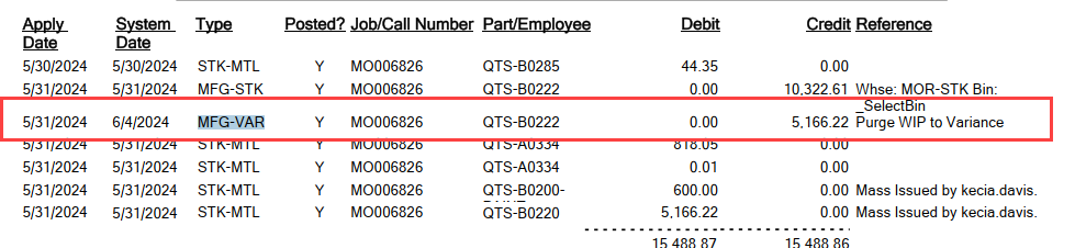

MFG-VAR Posted on 5/31. Capture COS/WIP was process on 6/4, but cutoff at 5/31. Job was not marked as Closed. Only Complete.
I would expect the cost to remain as WIP until the Job is Closed. After that, the $7,118.86 would move to COS/MFG-VAR

5/31 is the apply date, what is the Sysdate and time of that transaction? I did search for MFG-VAR KBs and there are a bunch. As long as the 7118 doesn’t capture twice I guess it is just a head scratcher.
Was doing some research on something else and came across this. It is very interesting, but I would have to test it to understand it more.
The Apply Date would have been 6/4 on this transaction. I went through tall the MFG-VAR transactions on the Inventory WIP/Recon report. It still doesn’t make sense that there was a MFG-VAR to post when the job was closed on 8/21.

Is there some off chance that the change log was wrong about the job never being closed before? I know you are not the OP @Alamdar, but I’m assuming you are in a similar situation where you know that the job was not previously closed.
I will say that there are things that do not trigger the change log. For example, a Data Directive that updates a table (not a great idea, FYI). I imagine you C# wizards have other methods that do a similar DB update that bypasses Business Objects.
