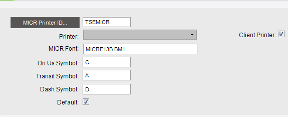

This is my current config:
E10 version 10.1.600.9

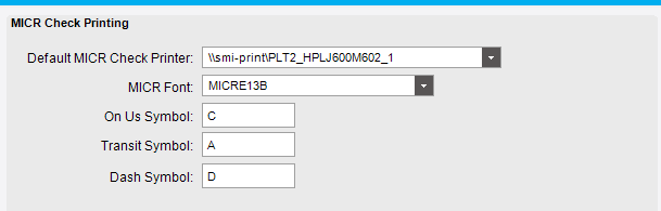

FYI My Settings on 500 - but again I had to have the MICR Font installed on the Server SSRS Not the Client for it to work since SSRS is the one generating the PDF or Sends the Print Document.
