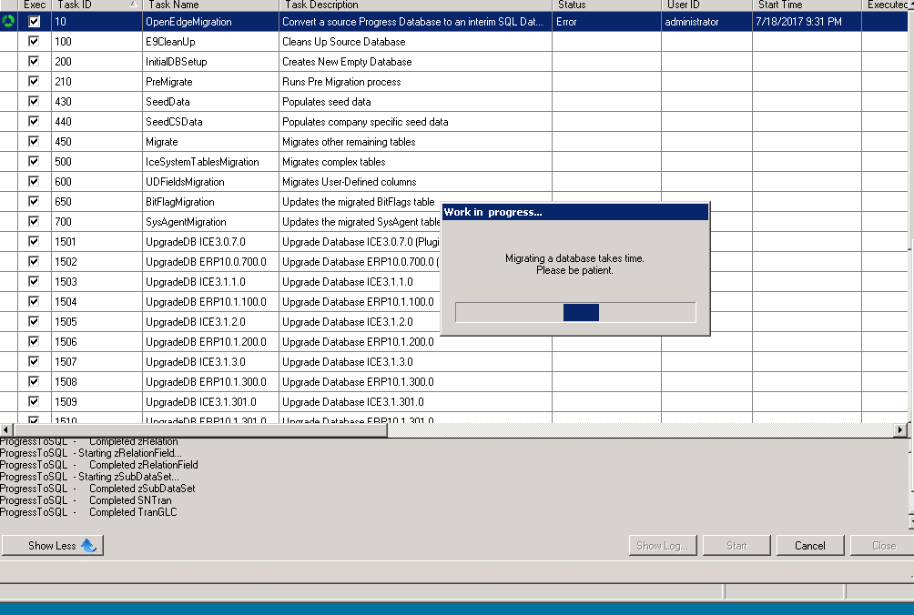

Is it normal for Task 10 to be stuck at this point (Completed TranGLC) for awhile? This task has been running for almost 13hrs and hasn’t seemed to move from this point for over the last 3hrs. Is it froze up? This is running on our current E9 PROD server and that server is running very slow this morning and it makes me think the program is froze.

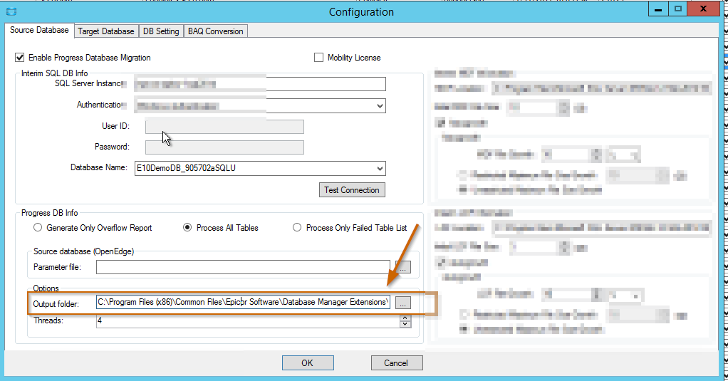

Check the output folder specified in the configuration for .dat files. Do you continue to see file growth? If so, it is doing “something” and as long as it is doing “something” it’s best to leave it alone :slight_smile:

It is not normal but it looks like it just finished TranGLC I assume its working in PartTran… shudder
How big is your DB?
The log files in the ‘progress output’ folders are updating.
