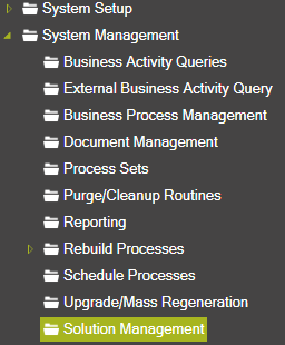

what changes are you talking about? Data? DMT is for data migration and changes etc but isnt the vehicle for tools and technology such as BPM’s, UI custs, baq’s etc etc… solution management is for all that.
You want to use the Solution Workbench
Customization Guide Page 862+
https://epicweb.epicor.com/doc/Docs/EpicorCustomization_UserGuide_101600.pdf
Thanks guys, that is exactly what I was looking for :slight_smile:
