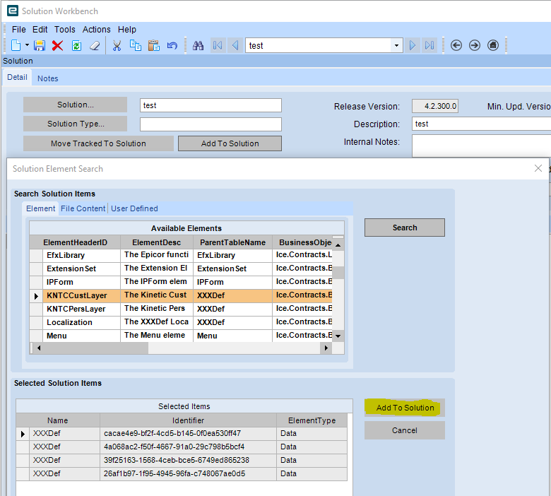

Yes, Solution Workbench… create a new solution… Give it a name and description so you can save it.
Click “Add to Solution”
Choose: KNTCCustLayer
Search… choose the layers you want to add to the solution.
(if you sort by Key2… it will group them by “application”)
Then click “Add to Solution”

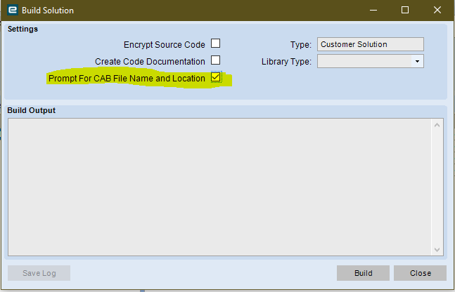

Once you have everything you want to include… Actions > Build Solution
Make sure you click this checkbox:
This allows you to choose where you’re saving the file.
