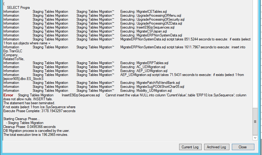

## Post #5 by @wi11king777
Ran with the ICE (everything checked and get the following error).
I will do data scrubber again.
FYI: I don't have 905.702 installed on the test system, I am using the backup from my 9.05.702A system to perform the migration.
## Post #6 by @aidacra
The scrubber won't address this particular issue. One of the sequence tables in E905 has a NULL for currentvalue. Support can provide you a process to resolve. Please call in/open a Support ticket via epicweb.epicor.com and someone from my team will definitely be able to assist.

## Post #8 by @wi11king777
Thank you for your help. I am putting a Epicor service call in.
