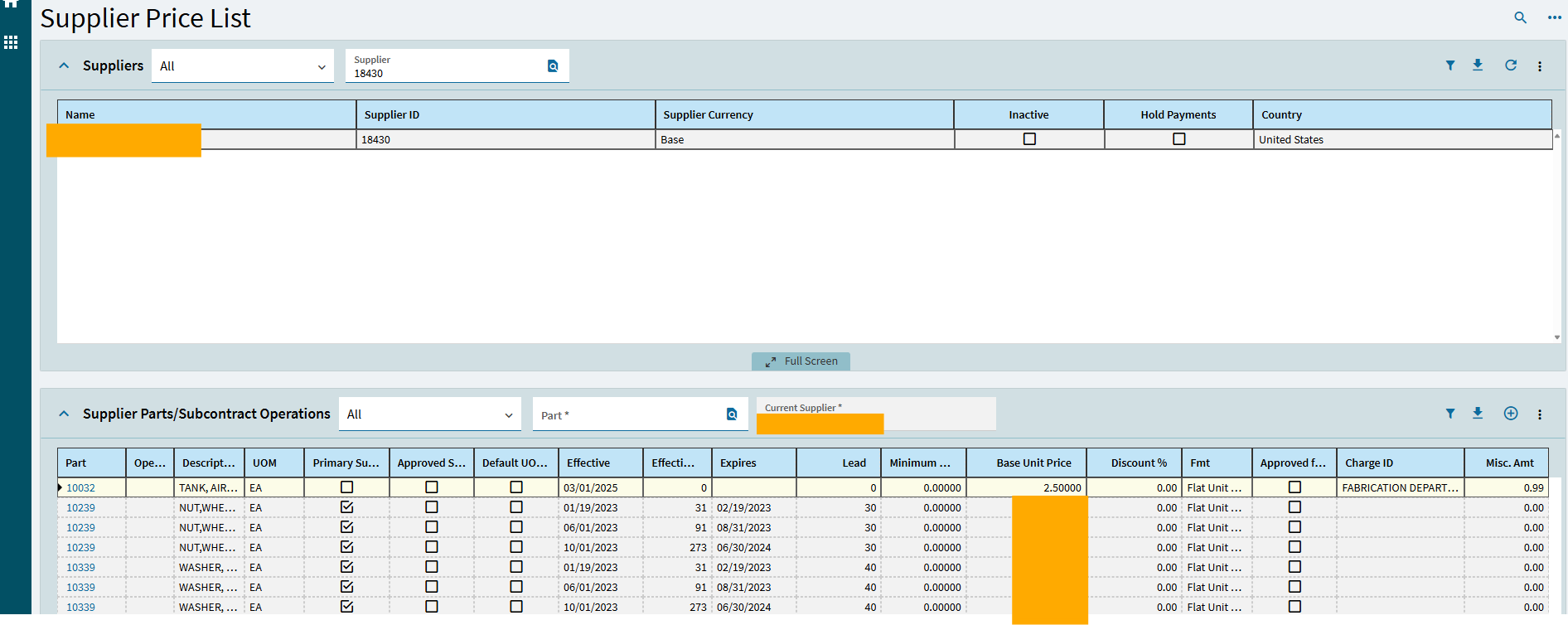

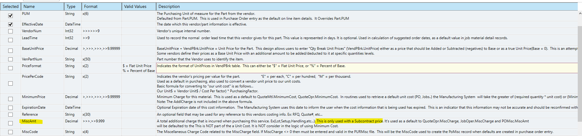

A coworker discovered that the Supplier Price List has a field for a (one) Miscellaneous Charge, and a field for the amount.
There’s nowhere to populate it in the UI, but you can do so in DMT.
So we gave it a whirl and I made a PO and… nothing happened. My unit price carried over, so it did see the SPL entry. But there was no misc. charge created on the PO.

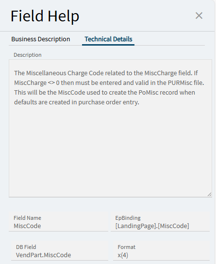

Here’s the field help for that field on the SPL. It makes it sound like this could work.
Anyone ever used this? Maybe we need the Landed Cost module or something else?

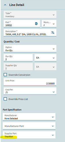

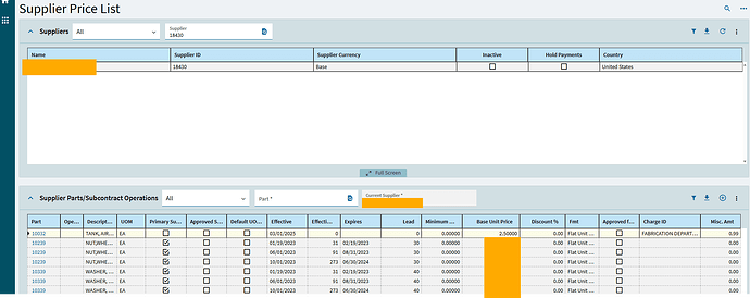

Just making sure, but did you enter a valid Misc Charge?
When you entered the PO, did the Supplier Part field have something entered into it?
JasonMcD
(Jason McDermott)
March 19, 2025, 5:23pm
3
Yes, valid misc charge. It’s validated in the screenshot.
Well… I didn’t add a cross reference if that’s what you mean.
I entered a price ($2.50) in the SPL and it carried over to the PO…
JasonMcD
(Jason McDermott)
March 19, 2025, 5:27pm
4

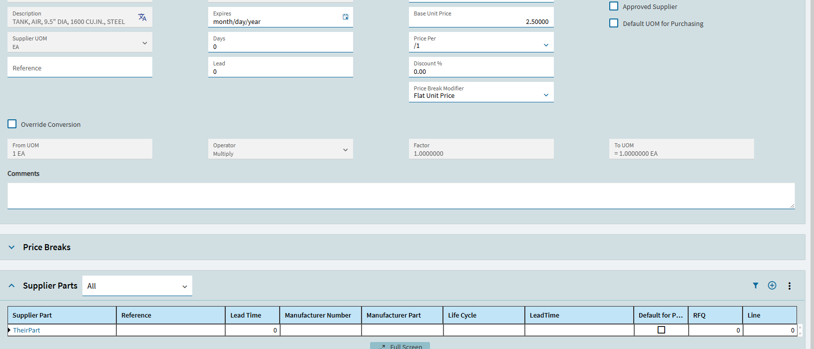

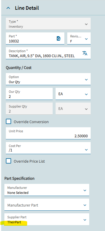

@jkane Here you go:
Still no misc. charge, though.

Ok. Last thing I would check is if there is a modifier (flat or %) in the table. I looked in 8 and those fields show. Maybe it needs that.
The other thing I thought of is maybe that only works on PO Suggestions and not manually created POs? You could always put a min on the part and run suggestions to see what happens.

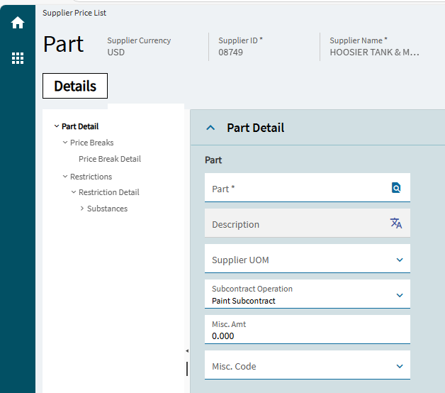

Hold up; I think I see the answers.
First, it looks like it is only for subcontract.
And if I did need the modifier, I assume it’s the same as PriceFormat
EDIT: I’d say this confirms it - the fields do become available if I add a new subcontract part:
