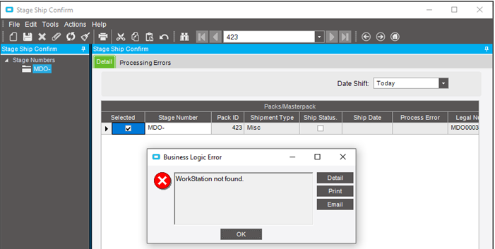

Misc Shipment Un-stage error
I’m unable to unstage the shipment
Have you setup a workstation for your user or selected one from the settings/tools menu?
Hi JAson,
May i know how to set it in User Account Maintenance > Company > Details.
You will need to create a Workstation first. This can be done in Workstation Maintenance:
Material Management > Shipping/Receiving > Setup > Workstation

A workstation can have default printers and scales. The user can be assigned to a workstation so their actions would use the best printer for their location.
The Help manual will explain it more.
