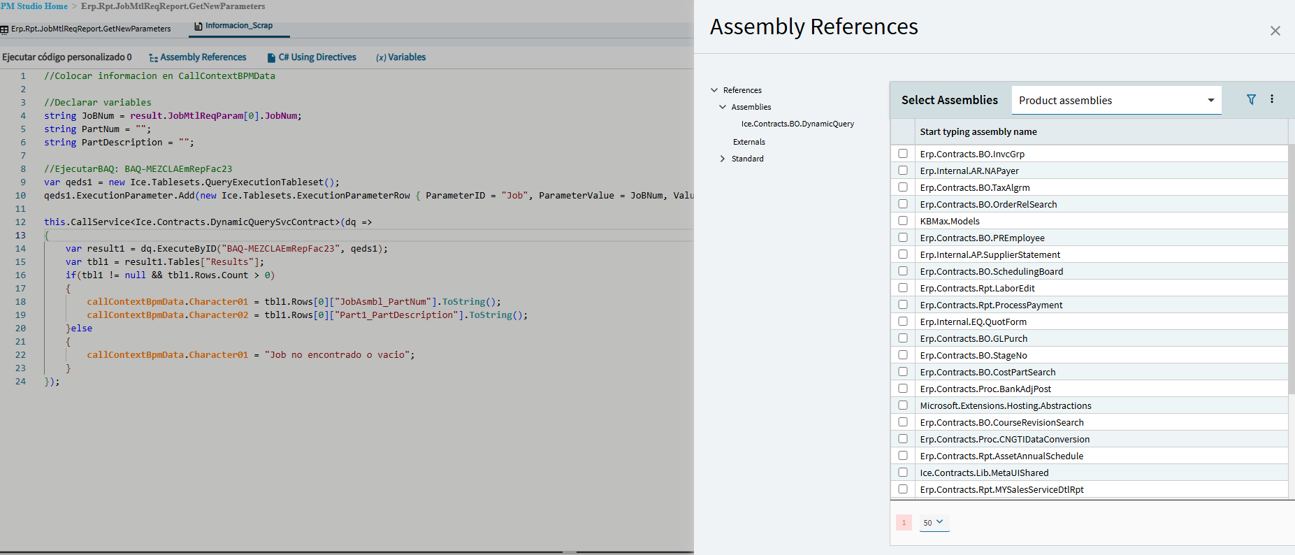

i have this BPM with the assemby reference “ICE.Contracts.BO.DynamicQuery” and remove it.

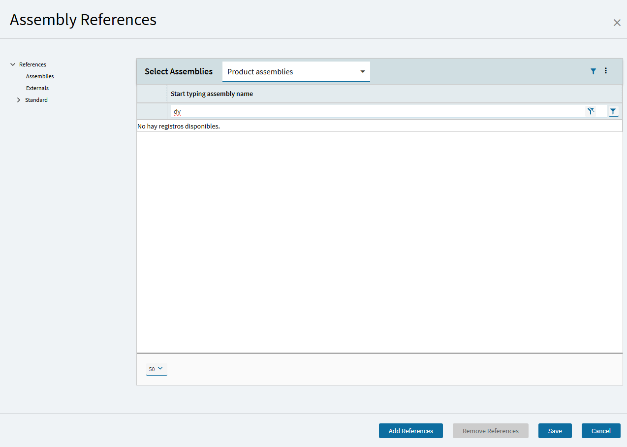

Now i want to add it again but i dont have it. sometimes appears sometimes dissapears and i notice i just load 50 assembly references loaded and sometimes in the same BPM i have a lot more.
i tried cache or try with anoher admin user or web explorer but sometimes i just cant get all assembly references.

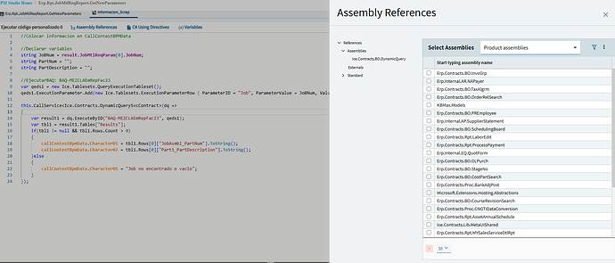

Same BPM:

It is case sensitive. I have a thread where I solved this.

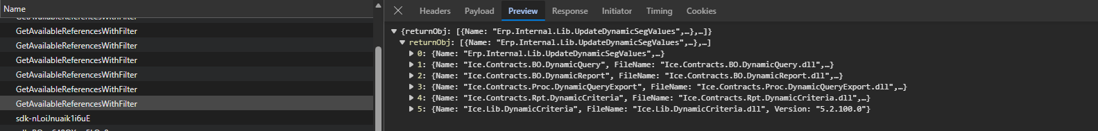

i allready imported the ReferencesSpeedupKineticWithCache BPM and looks at the Network console and looks like i have a response but the table doesnt update:
