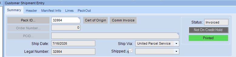

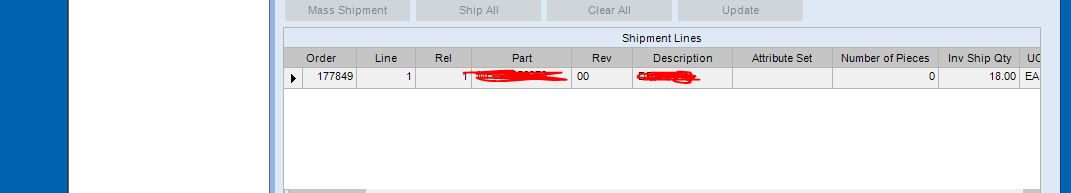

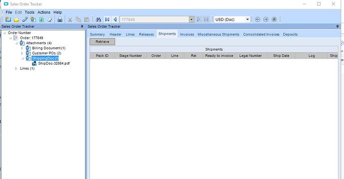

We have a few packing slips that are not showing up in the Sales Order Tracker from the Shipment tabs. When we click the Retrieve button, nothing comes back. When you open the packing slip in Customer Shipment Entry, the packing slip shows the Order number on the detail line. But it is not showing up in Sales Order Tracker.

I am an Admin and can see all Territories. Also this is happening on more than one Order in Order Tracker. I ran a BAQ and SQL and can tell the packing slip is tied to that order. Just not showing up in the shipment tab. I have cleared the cache and purged the personalaztion. Also just for kicks I opened the program the base. Changed nothing. Still unable to see the packing slips.

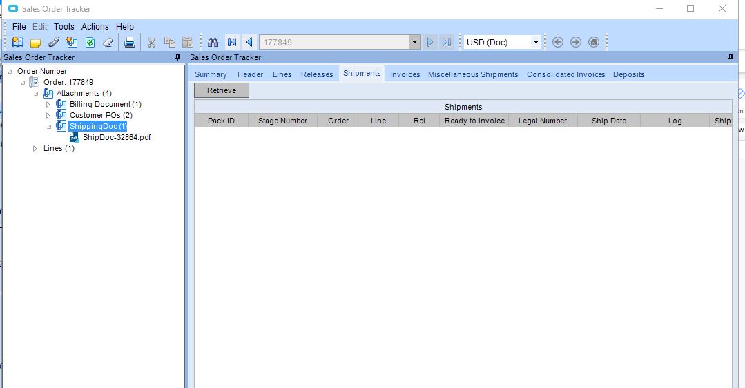

I went and checked this morning. I logged into the salesperson’s workstation and pulled up the order in Order Tracker, where he is the main salesperson. He was unable to see the packing slip in the Shipment tab as well. This is a new salesperson, and he was assigned to this customer and a list of other customers about 6 months ago. This problem just started in July and is carrying over into August. I have a list of about 74 Orders not showing Packing Slips in the shipment tab in Order Tracker. I can confirm from a SQL query that the packing slip is tied to that order. It’s just not showing in Order Tracker.

If I go to Actions → Retrieve Transactions it gives me nothing still.
