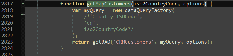

I dumped the APK file, opened it with WinRAR, got down into \assets\www\app\services\erp-data-service.js.
Somewhere around Line 2817 is the function that places those filter options, and I broke it by commenting it out. Don’t know if I broke anything else yet, but the map loads all customers just fine now.
Downsides are, the app’s not going to auto-update anymore, and I had to spend a bit of time re-signing it so I’m able to sideload it on Android.
