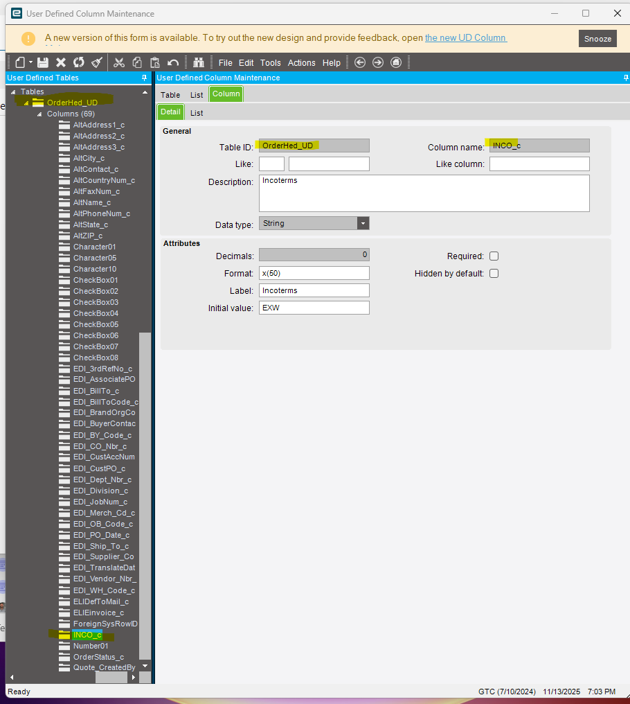

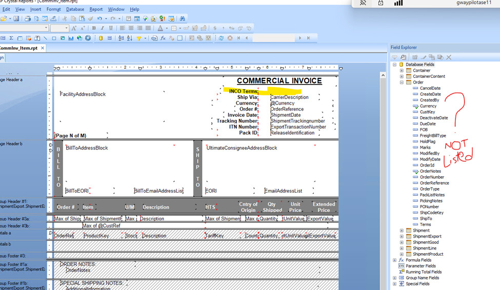

We have added a custom field to the Order Head and would like it to display on the Commercial Invoice form from Quick Ship. How to do get crystal reports to see the field. It has been a long time since I have worked with crystal. I am thinking I need to update the dataset but I don’t know what connection it is using. I thought it would be ODBC but it doesn’t appear to be. Any help or direction would be greatly appreciated.
So the crystal reports that quickship uses are linked to the database and xml output from the quickship environment.
Depending on your Quickship version you will either map your ud field to using the data mapping tool in kinetic to another field in quickship. Im not sure how good that is.
And i believe that in newer version of kinetic they now have a native incoterms field on order entry customer shipment entry and customer entry. And i think they are passed from kinetic to quickship.
You have to add the field in the data mapping in QS. Out of the box UD fields don’t sync to QS.
This has changed I think. In the most recent versions of QS there is no connection to the dB. It only uses the XML dataset it generates when you run the report.

The freight service does or the new REST interface does for shipping definitely. But the report data comes from the QS dB. They generate a XML file with the data that gets fed into the crystal report.

Back to the OT question … how do you know which fields are mapped and where they are mapped to?
I was told by support to use REST API or the data mapping but the version we are on does not support the data mapping so I am on hold until we upgrade in a few months.
What version are you on? The FreightSVC data mapping has worked for years now.

I do know when I do the data mapping i don’t see the custom feild.
