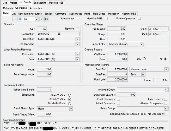

A screenshot of a typical job:
Capture123frfdssfd
In this example the lathe operation takes 7 minutes per piece, with a 2 hour setup. But lets assume the machine they want to run this on is really old, and the setup will take longer, as will the cycle time.
How do I go from this, to having operation standards? I guess I don’t get the idea of operation standards as their own entities. Does this presume that you create an operation standard for each operation? Wouldn’t that get out of hand? Or do you setup standardized operation standards like 10 minutes per piece, 1 hour per piece, 10 piece per hour, etc…?
I am just doing research now, so no major task just yet. Can you help me understand the operation standards?

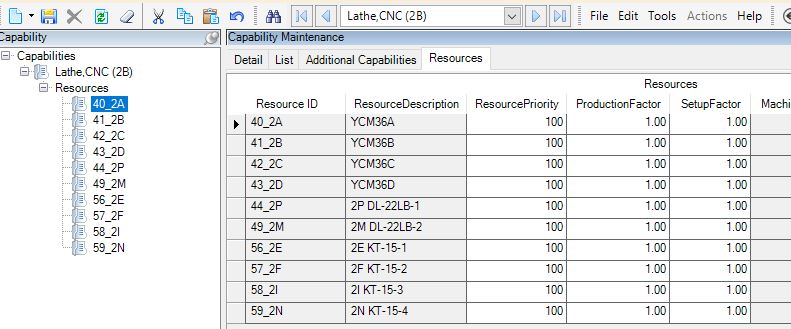

Don’t use operation standards, use the Production and Setup Factors on the Capability.
I don’t know if I have seen those before! We have them all set to 1. Does this mean that if we set one to 1.5, that it produces 50% more parts, or takes 50% more time? Similarly, if we set to 0.25, does that mean we make 1/4 of the parts, or it takes 1/4 of the time? Does anyone currently use these factors to good effect?
Thanks!
They are time based, not quantity based. Under 1 is faster and above 1 is slower.
So glad you said that! :slight_smile: I like this approach way more. It is exactly what I needed!
When I change the factors, where will I see the differences? For example, I am setting one resource to a factor of 2, meaning it takes twice as long. Our op standard on the job, is 10 min/pc, estimating 2.67 hours of time for 16 pieces. Where can I see that this will actually take 5.34 hours? Do I have to run global scheduling or something like that?
Yes, those values affect the schedule once the resource is determined. You might need to set the priority of that machine to make sure the schedule selects it. So, if you had two jobs for the same part in the system and the main resource is selected, it will show that it takes 2.67 hours. The other job would select the other resource and show that it will take 5.34 hours.
