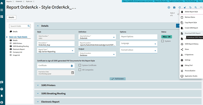

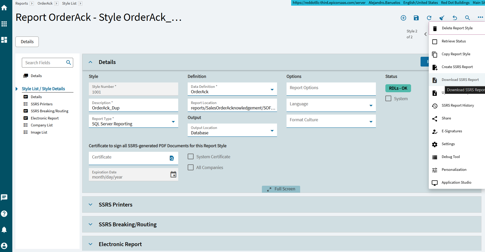

I’m currently modifying an existing report to add an additional field. Because this is a standard report, I first duplicated the Report Style.

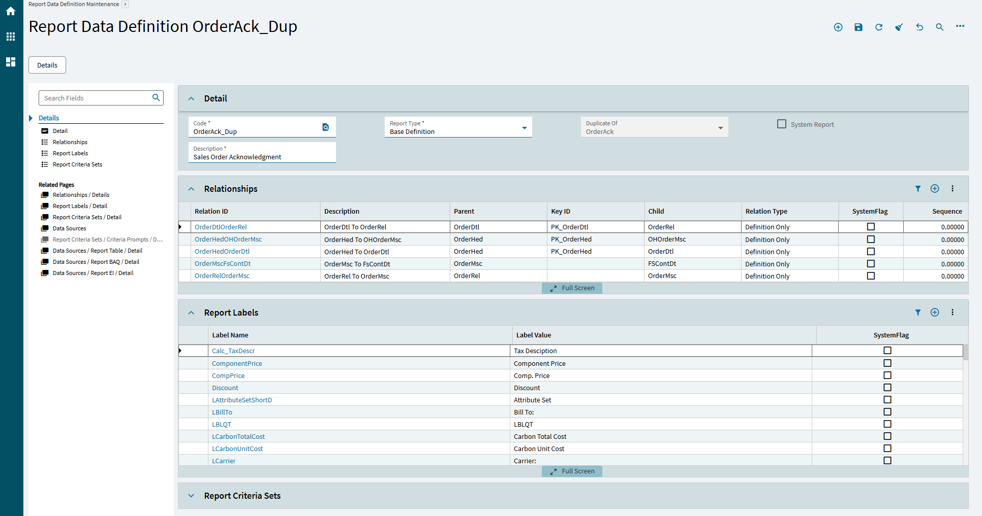

After duplicating the style, I added a new Report Data Definition to the existing report style so that I could download the SSRS file.

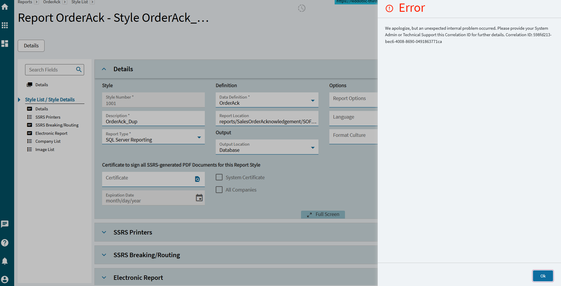

I was able to successfully download the SSRS as a ZIP file. However, when I tried to upload it again even without making any changes the upload failed.

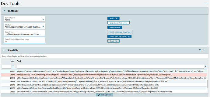

I checked the correlation ID and found the following error message:
<![CDATA[System.ArgumentException: The report path (/reports/SalesOrderAcknowledgement/SOForm) must be within the custom report directory (reports/CustomReports).

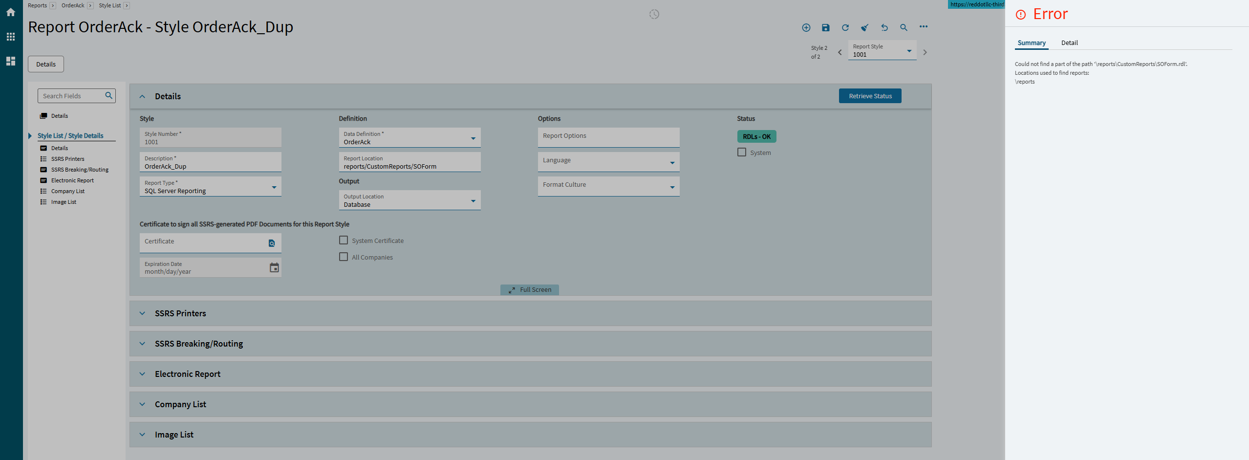

On the new report style, you have to change the report location to be reports/CustomReports… instead of reports…
Something like
reports/CustomReports/SOForm?

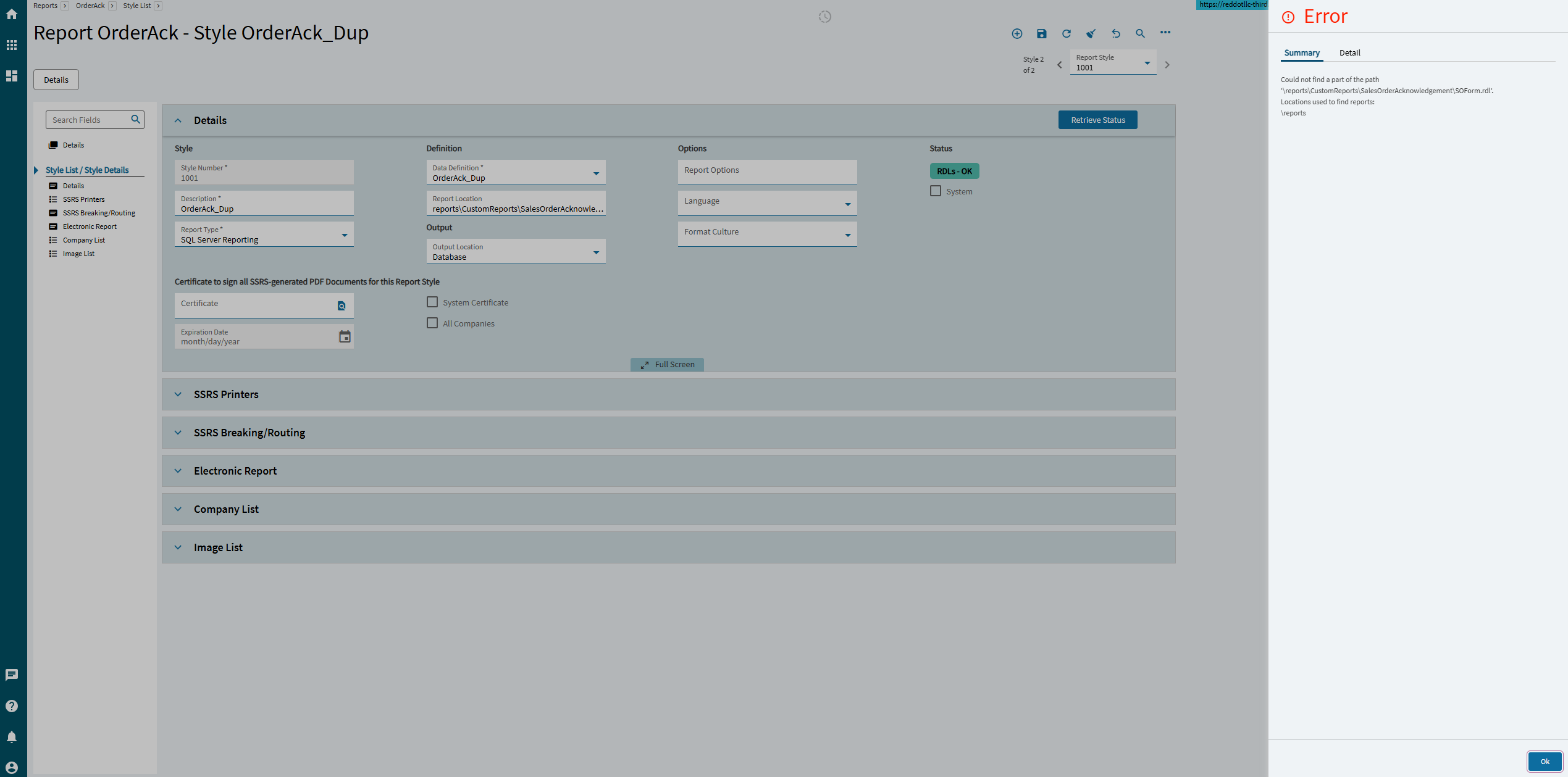

I got the following message:
Business Layer Exception
Could not find a part of the path ‘\reports\CustomReports\SOForm.rdl’.
Locations used to find reports:
\reports
Error Detail
Correlation ID: 62b62152-4f8f-4327-a8db-258d168c04cd
Description: Could not find a part of the path ‘\reports\CustomReports\SOForm.rdl’.
\reports
Program: Ice.Services.BO.Report.dll
Method: ExtractAndUploadReportsZip
Table: undefined
Field: undefined
It is wherever you have the custom report saved on your computer. I assume for you it must start with Reports\CustomReports\SalesOrderAcknowledgement\SOForm
Another thing is that you will have to change your data definition to the new one you had created (OrderAck_Dup) if you want the custom fields to be called.

It is refereeing to the file you are uploading. This is happening because you downloaded the report style first, and then created a new report style. Otherwise Epicor would have created the folder for you. Not too big a deal as you just have to change the location of where the zip file is saved.

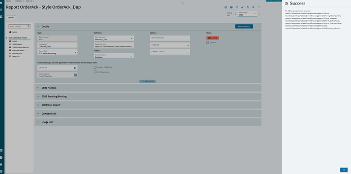

So after changing it into something like this:
reports → CustomReports → SalesOrderAcknowledgement → SOForm
And compressing the file into a new zip.
Got it working thanks a lot!
