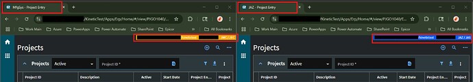

:white_check_mark: Final Result
You’ll now see something like this in the browser tab when the form is loaded:
