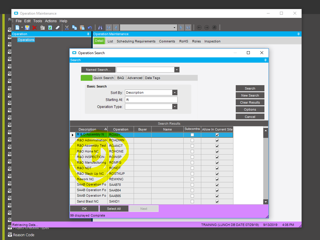

Oh, I thought Operations were. Because I see a check box that says Allow in current plant. When I open Operations in the new plant that check box is not checked.
you can see in the previous screen shot it is checked but in this new plant they are not.

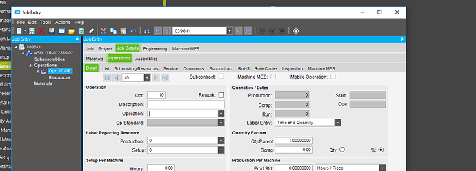

When I create a job and add an operation. I have none to select from.
The only thing that will show up in that drop down box are operations currently tied to plant-centric resource groups.

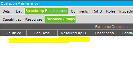

I do have one assigned. But I am not following you and I am not sure you are following me. If they are not plant specific then I would think the operation would be available to use in the new plant. It is not.
It will be available if you connect a primary resource to it. This has to be a resource group or a resource in the new plant. The tab I displayed above is where this happens. When you connect a primary resource or resource group to the operation in the new plant, the operation will be available in the dropdown box in the jobs of the new plant. Take a look at the old plant operations and see how you have them configured. Or, post a pic of what your resource group, resource and capabilities tabs look like on the operations in the new plant.
