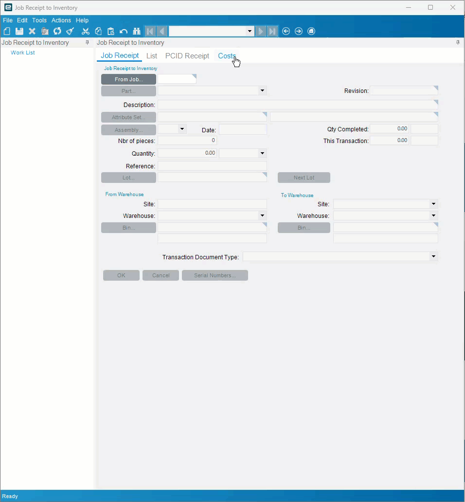

In the classic screen it is very easy to move a tab. In job receipt to inventory I’ve moved the costs from the tab to the lower section of the screen.
CostMove

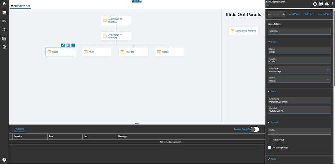

How can that be done in application studio? I’ve played with the page type and parent with no luck. If I have to, I will just add a panel card and add the fields.
I don’t think you can move a “Page” into another “Page”…
But you CAN copy/paste entire panel cards.

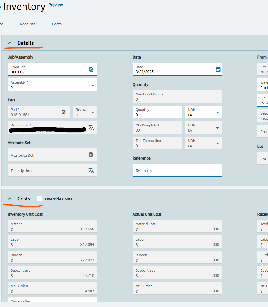

So, Ctrl-C the panel card in Cost… and then Ctrl-V in the Details page.
Thanks! I didn’t realize I could copy the full panel card.
